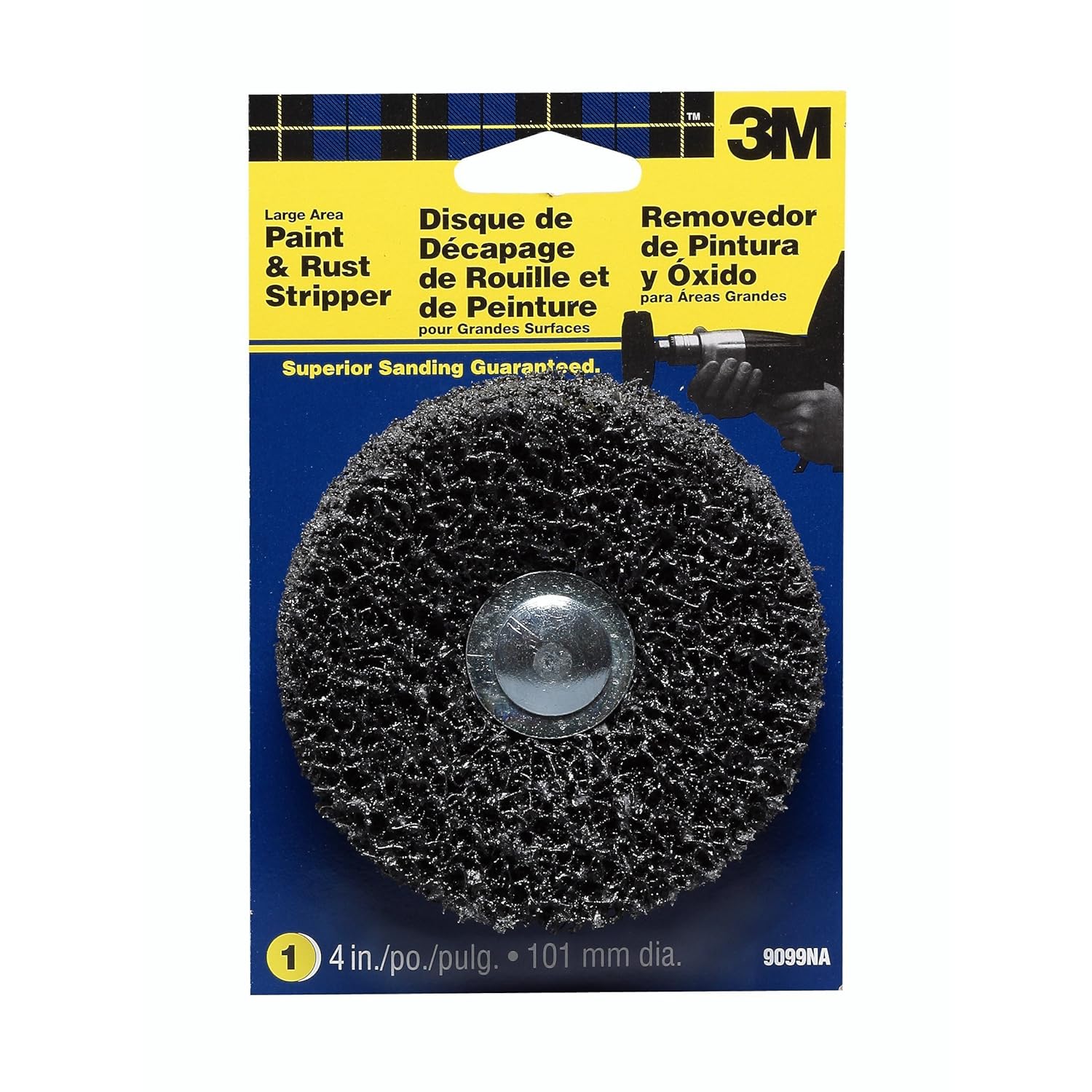

Something like this is my favorite. I've used it with my drill to remove paint/rust from a set of rear springs. Also used it to scuff up my set up SuperSkinks before painting.
I've also used to it to redo my railings for my front steps of my house. Took that paint and rust right off!
http://www.amazon.com/3M-9099DCNA-Large ... B00004Z4DV
I usually pick it up at HomeDepot. Comes in brown and purple. Depending on your favorite color, lol. (Actually its for different types of uses.)
8)

NIiiiceee. And you posted a link with it. :rockon: Thanks.
