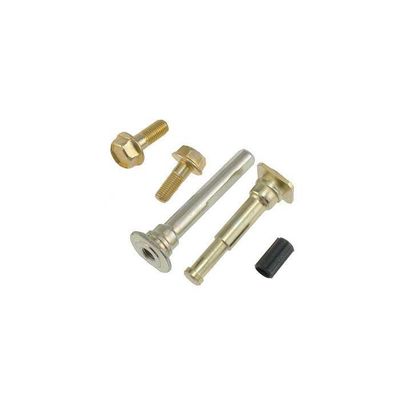

Jeepjeepster wrote:
So, here's a "Duralast" replacement pin set for the front:
Are the two pins actually that different? Having never taken off the pins for inspection, it seems bizarre that one side would have the sleeve an the other not.
Dan
245/75R16 GoodYear Duratracs
 Post subject: Re: How hot should brakes be getting?
PostPosted: Fri Mar 15, 2013 7:48 pm
Yup, wild huh? Ive got two sets of pins so i may reuse my old pins so ill have all four solid pins. Right now ive just removed the rubber sleeve.
