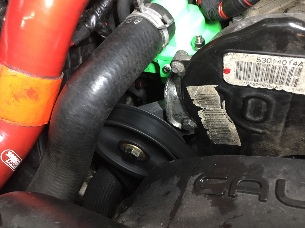

Will use stock serpentine belt and one rubber hose going from the thermostat to the viscous heater is removed from the thermostat and discarded.
Then the outlet hose is removed from the viscous heater, shortened about 1 inch and connected back in place to the thermostat where the first hose was removed. (supplies hot coolant to heater core)
Will post some pictures of new hose arrangement later tonight. :wink:

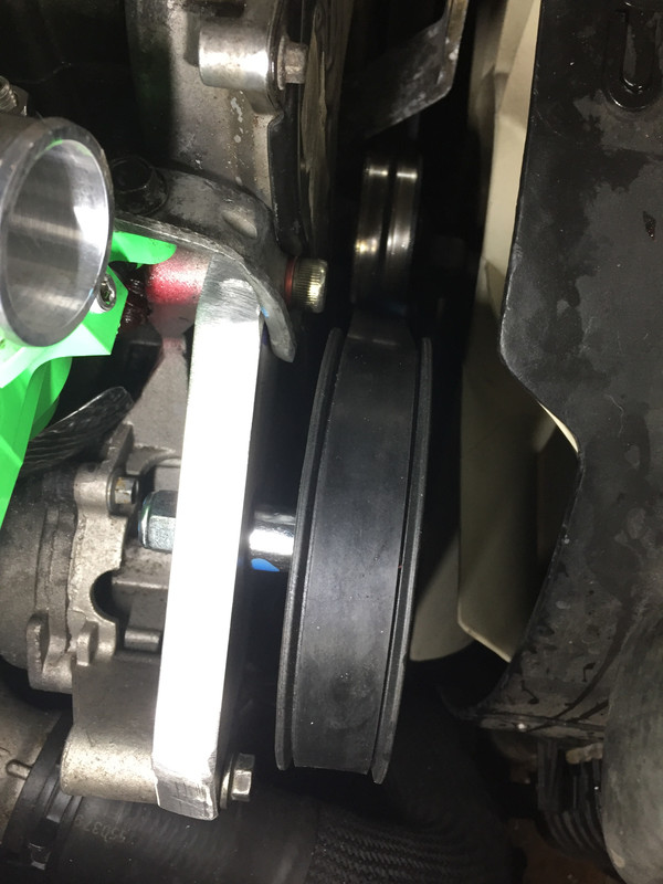

First is a picture of the new hose arrangement, coolant leaves thermostat housing and goes directly to heater core inlet no longer going through viscous heater which is no longer there. Second picture shows belt alignment. Worked a long time on getting the spacing/belt alignment just perfect.

Install is complete, no more viscous heater.
Additional pictures.
