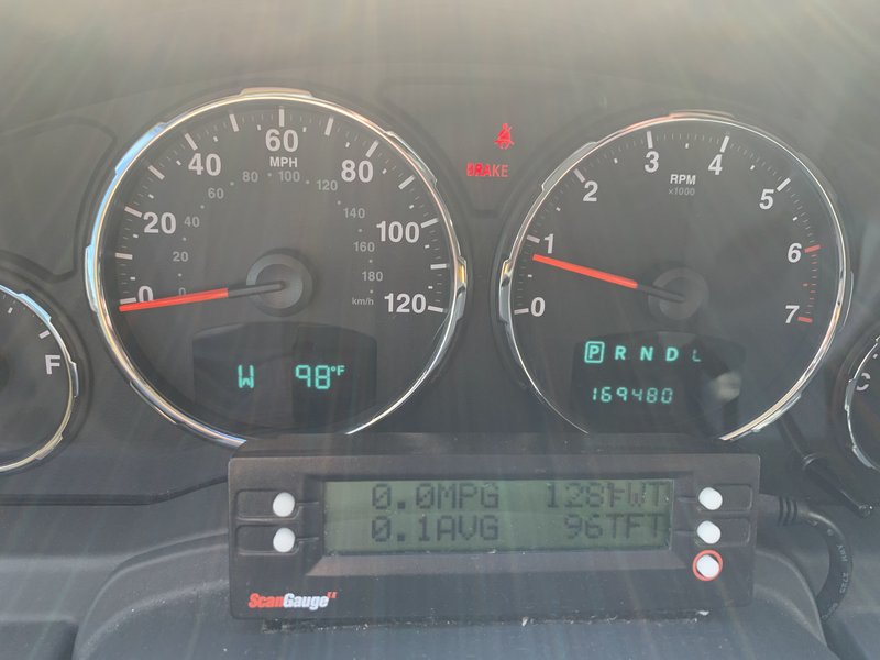

Recently installed a Scangauge monitor -- primarily to keep a close watch on engine temperature because the radiator fan has a history of not always operating. Heat rising when stalled at a drive-through , etc.
Added a manual switch to start the fan on command. Deciding now the parameters of when to engage it. I think around 215 degrees F.
In the process, I tried to add an "Ambient Air Temperature" reading using their "X-Gauge" programming feature, but it stays blank. The gauge manual says the vehicle simply may not report that. Does anyone know if that is right, or should it work ?
The Scangauge has a built in function for engine temp, which is the degrees F Water Temp in the radiator (°FWT).
The Transmission Fluid Temp (TFT) is an Xgauge command and you can find details here:
http://www.lostjeeps.com/forum/phpBB3/viewtopic.php?f=104&t=84482
Ambient air temperature is the same as the outdoor temperature displayed on your dashboard: it comes from the sensor behind your bumper and in front of the radiator.

Mine is a 2002. Don't have ambient temp on the dash. The programmed ambient temp reading now gives random, erratic numbers, and is not always blank. For instance, when it started "working" the temp was about 50* and it all of a sudden said 93* and never changed.
Transmission is 45RFE. The Wrangler link talks about codes for the 42RLE, but I see they weren't successful for some who tried them too.
I followed these links and don't think I can get trans temp; would be the next thing I'd like. I actually have a digital trans temp gauge but mounting it and getting through the firewall is not going to happen.
