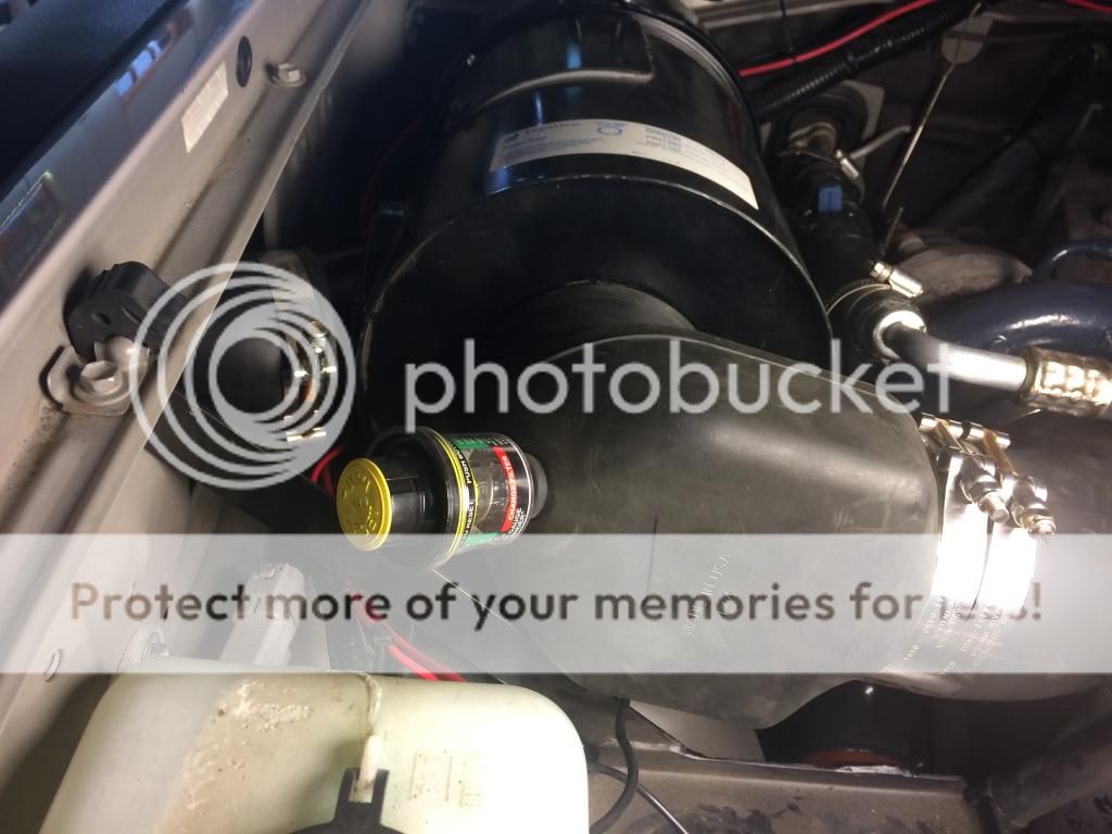

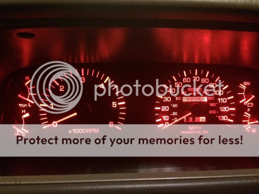

I have done a few modifications since my last post.
Installed filter minder. I don't want to change out the high dollar filters before it' time.
Installed red LED lights in the dash.
Made a bracket to finally install my Vaiair compressor underneath where the spare used to be.
And a few shots from my recent trip to Big Bend National Park.

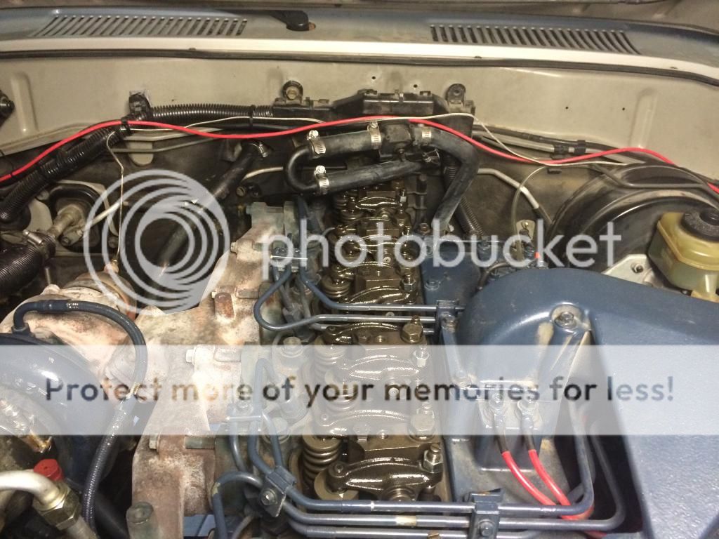

Been awhile since I've added to my thread here. I notice some new views so here is the latest. I did some power upgrades to the engine.
Added 4K governor springs so now the Cummins will fuel to 4,000 rpms rather than defueling around 2,200 rpms. New springs (right in photo) compared to stock springs.
With the new governor springs in it was time to upgrade to HD valve springs and retainers. New springs (right) compared to stock springs.
Now for the real power upgrades. New fuel plate along with AFC housing spring. New fuel plate (right) compared to stock plate. The added about 50hp and 100lbs of torque.
With these upgrades the Cummins is a beast. It really woke it up. I did all the work myself which took about two days of leaning over the engine taking my time to make sure everything was done right. I also adjusted the valves after installing the new ones. The 12v Cummins is so easy to work on even though its crammed in the Land Cruiser.

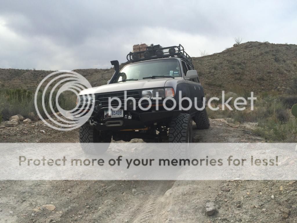

A couple photos from Big Bend this past weekend. I got to test my fridge/freezer and solar setup as well. Set the fridge at 35 degrees and left it on for 4 days. No problems with battery drain at all. I installed a 100w solar panel flat on the roof and saw 4.5 amps during peak sun. Around .5 amps during the morning and late afternoon. I need to figure out a way to angle it toward the sun when parked for better morning and afternoon charging.

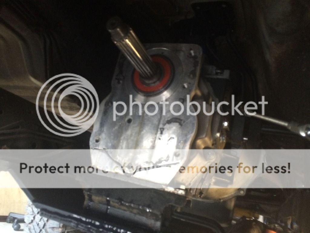

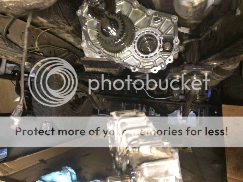

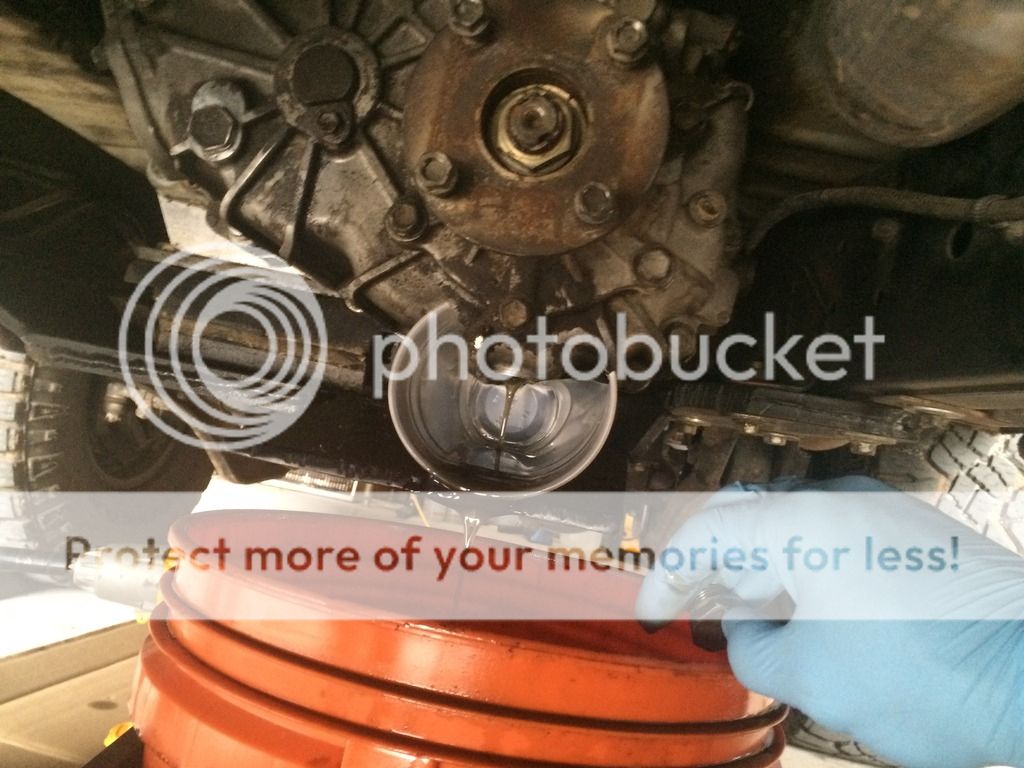

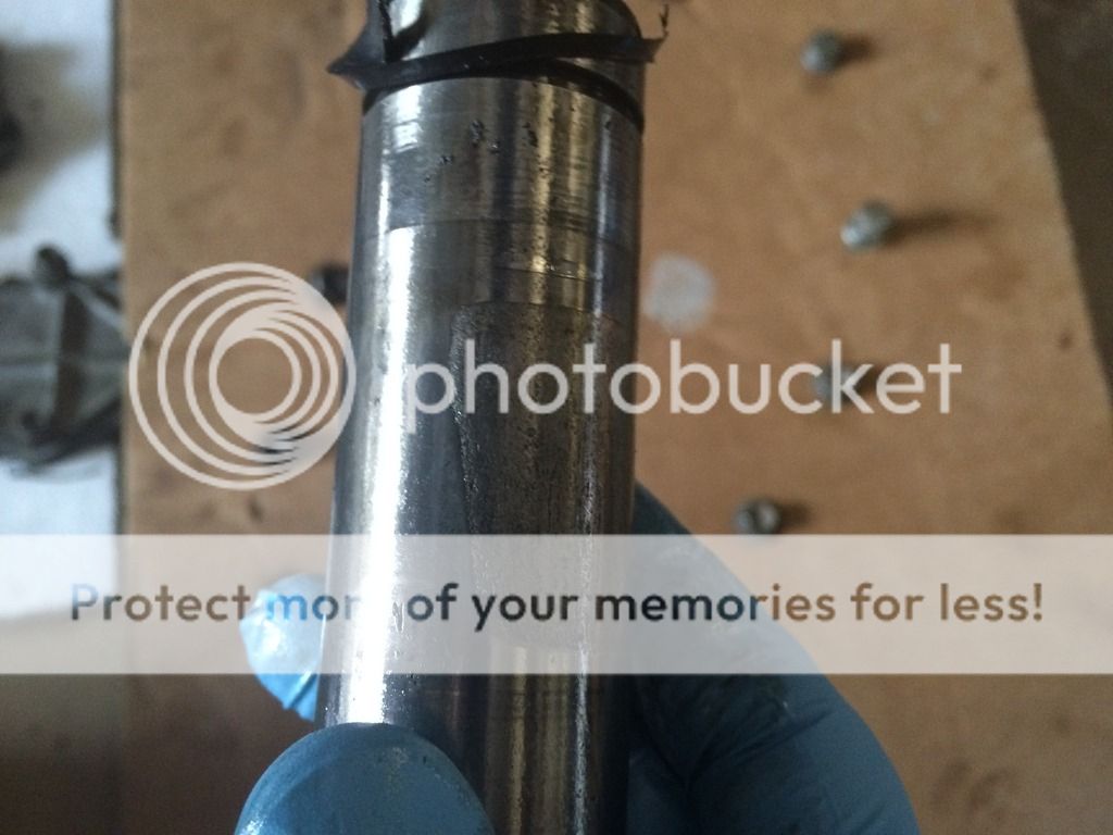

Time to rebuild the transfer case and install 2.88:1 low range and .92:1 high range gears. Since I didn't get it rebuilt when installed I was getting a whine that was starting to get annoying. After tearing it down I hopefully found the culprit. I had a lot of wear on my idler shaft as well as a bad o ring resulting in a leak between the TC and transmission. Most of the 30 year old gaskets and seals were toast.
No lift, besides the 4" lift on the truck, so laying on the creeper was the only way to go.
Use the cup method to neatly drain the TC into the bucket.
Back half of the case off. Toyota used a split case in the 40 & 60 series Land Cruisers.
Worn out idler shaft has seen better days.
TC completely removed showing the rear trans and AA adapter.
And finally a mostly dismantled transfer case.
Now I have to wait on the gear which are coming from Australia. Would have liked to had everything ready but I needed to tear it down to figure out which input gear was needed since their are two versions.

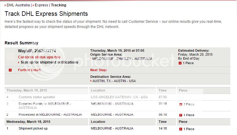

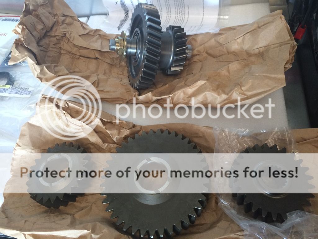

It's amazing how fast my gears are getting here from Australia. I should start the cleaning this Sunday and start rebuilding the case on Monday.

All reusable parts cleaned up for reassembly.
New gears that will be going in.

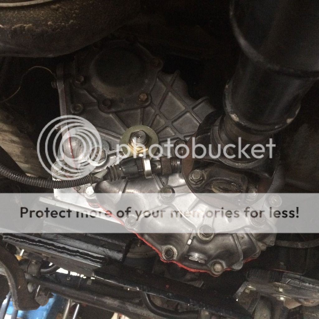

 Post subject: Re: Land Cruiser Diesel Build
PostPosted: Tue Apr 07, 2015 10:04 pm
Joined: Tue Apr 27, 2010 7:34 pm
Posts: 309

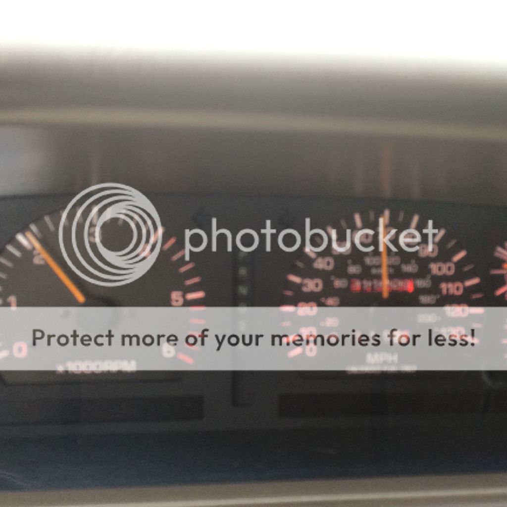

Everything back together and running great. RPMs are down on the highway and my low range is even lower so I'm happy.
