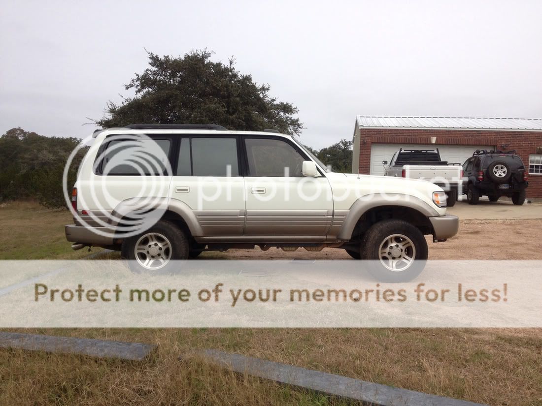

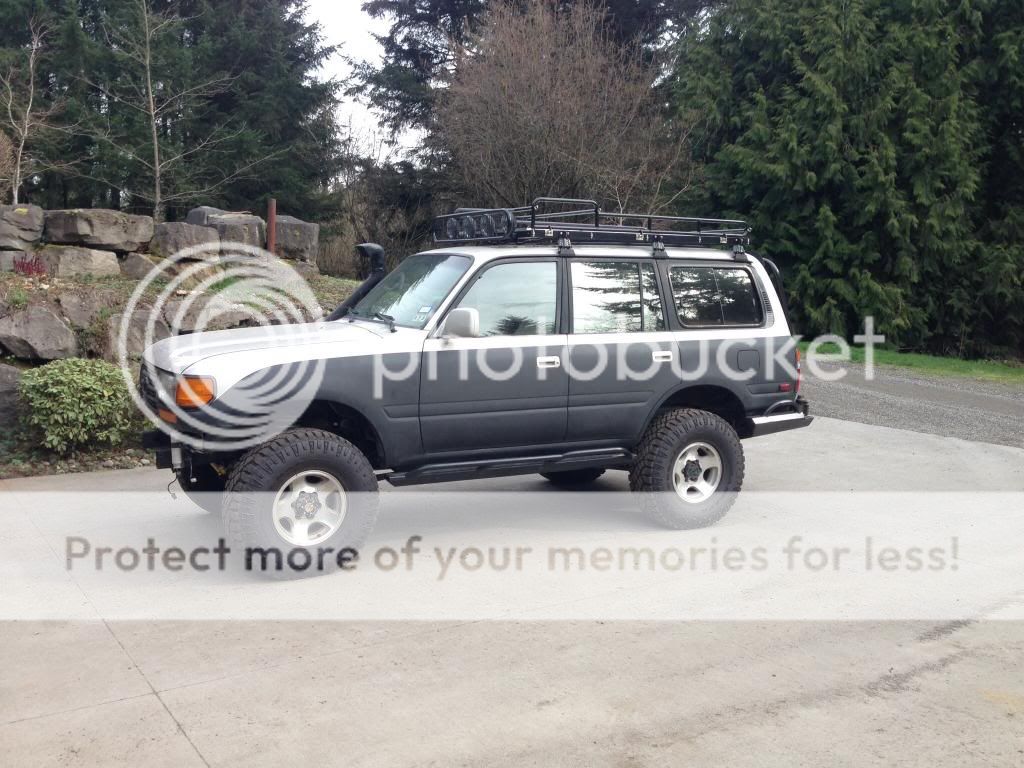

Here are some photos of the LC. I will update when the shop starts the work.
The day I brought it home.
As it sits today. Just got done spraying it with U-Pol Raptor liner this week.

It's not hard. Just a lot of prep before spraying. I will be doing the CRD since I have plenty left over. Need to fill the holes on the rocker first. I ripped off the molding when I put on the sliders.

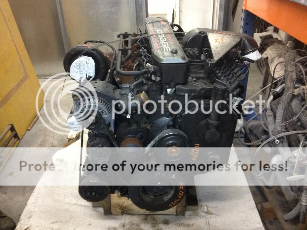

Here's the Cummins 12V 6bt that will be transplanted into the cruiser. Still about a month out before install starts. I have a plethora of parts to get still. My goal is to get it ready for late summer trip to Colorado.

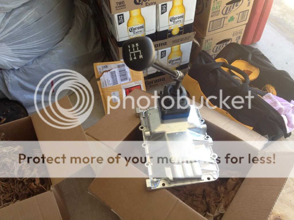

I got the newer top plate for the NV4500 in along with shifter housing and BD diesel short throw shifter. Will find out if the shift lever needs to be modified once installed. I also ordered a twin stick kit for the 60 series split case. I wanted to keep the 2WD low range option that I had with the CDL switch/pin 7 mod previously. These are the last bit of the parts I will get. I will leave it up to Jonesy's to get the rest once the conversion starts.

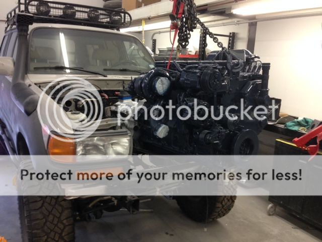

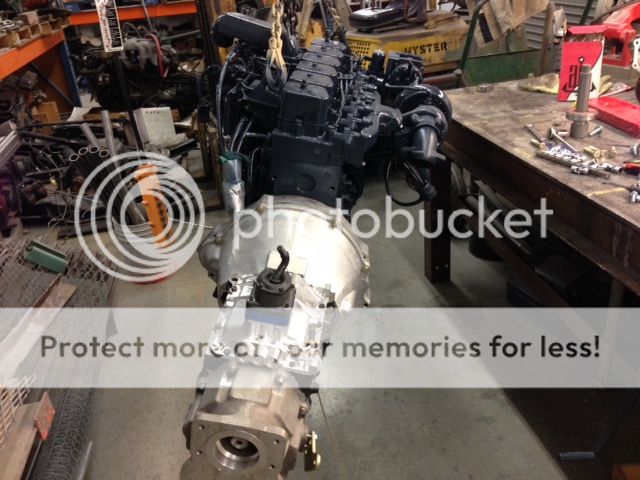

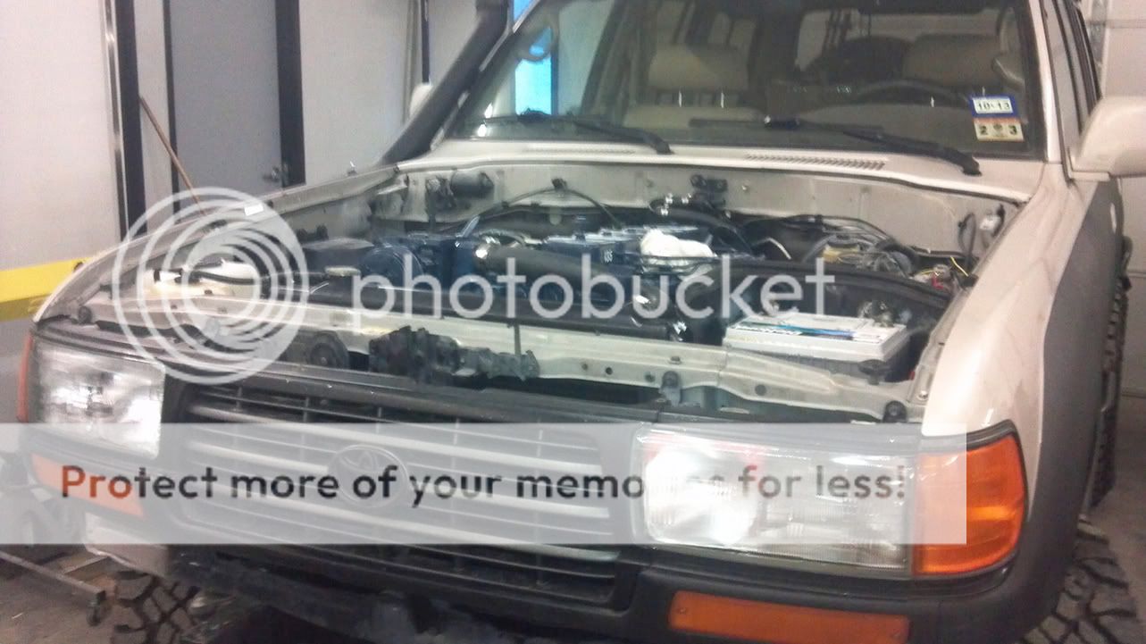

Conversion has taken longer than expected but things are looking good to have it running by the end of the year. Here is the progress so far.
I also just picked up this Lexus LX 450 for $1,500. The good it has factory front and rear lockers and is clean and dent free. Also identical to my 80 series so it's a perfect parts vehicle for future needs. The bad it has a blown head gasket but I will be dropping in the original engine from the Land Cruiser to give it life again. It will be the kid hauler that way the Land Cruiser can stay in expo mode full time.

PostPosted: Wed Mar 19, 2014 9:13 am
Joined: Tue Apr 27, 2010 7:34 pm
Posts: 309
Build has been slow lately. Added a 1" body lift for hood clearance and exhaust routing. Right now we are waiting on the inter cooler to show up for install. Still need to cut hole for TC shifters. All drive lines and clutch stuff is done. Hoping to have it ready in a month.
