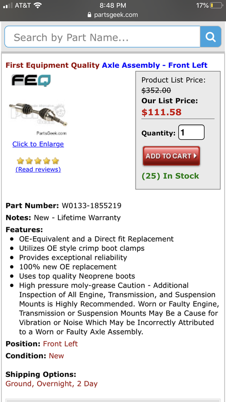

So I dont think Napa is still processing the axels unfortunately. If you can find one, it will be from a third party source according to the guy at Napa. (Which Iv had a hard time finding) I did find an alternative OE spec replacement made by FEQ. Not sure of their reputation tho.. I talked to a tech at CarID to confirm and they also said its to OE spec. Original price for the FEQ cv axel is the same as the Mopar original but now priced at fraction of the cost.. i’v found it on CarID and Partsgeek (priced at a $15 difference). I may try these as they are the only ones to say they are to OEM spec and was their recommended replacement. Comes with a FEQ 24 month or 12k mile warranty.
