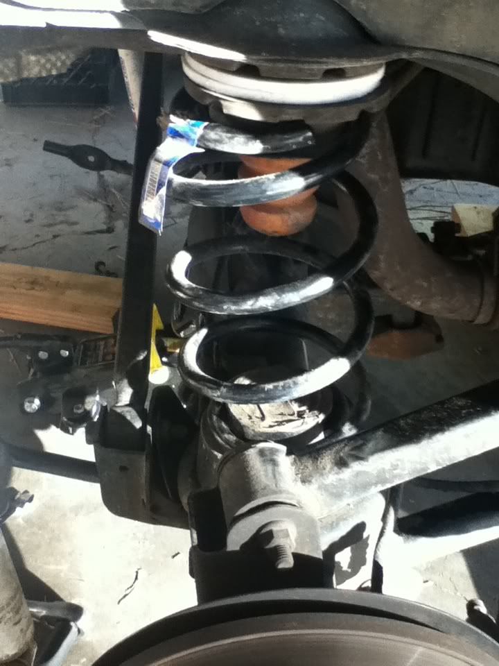

Front bumpstops are important too...
I filled in my rear spacers with plywood rounds and sealed it all with rtv. Why they make them hollow i don't know. :dizzy:
Hard to see it in the pic but look closely at the bottom spacer.
