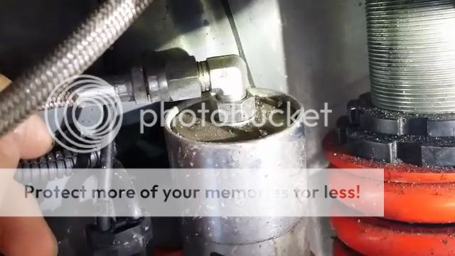

so all bolts are tight. Here is a pic of the front spring, do all the 4in lifts look like this? It needs to be this compressed to make the truck look level front to back.
[url][URL=http://s30.photobucket.com/user/gldoerr2010jeepkk/media/Mobile%20Uploads/20140509_182454_zpspp0mp0mc.jpg.html]Image[/url][/url][url][URL=http://s30.photobucket.com/user/gldoerr2010jeepkk/media/Mobile%20Uploads/20140509_182503_zpstk1tnaua.jpg.html]Image[/url][/url]
it seems real tight i think the springs are the doing the clunking.. but im not sure

Looks like you're leaking something unless you just washed it.

The spots are from driving in the rain for a bit. No leaks yet....

The springs will look like that, they all do. They are a progressive rate spring so the top coils will touch.
As far as noise looks like you have it cranked way up there will be interesting to see your measurements, plus I see you have quick disconnects on the sway bar ( they are useless and will make noise)
