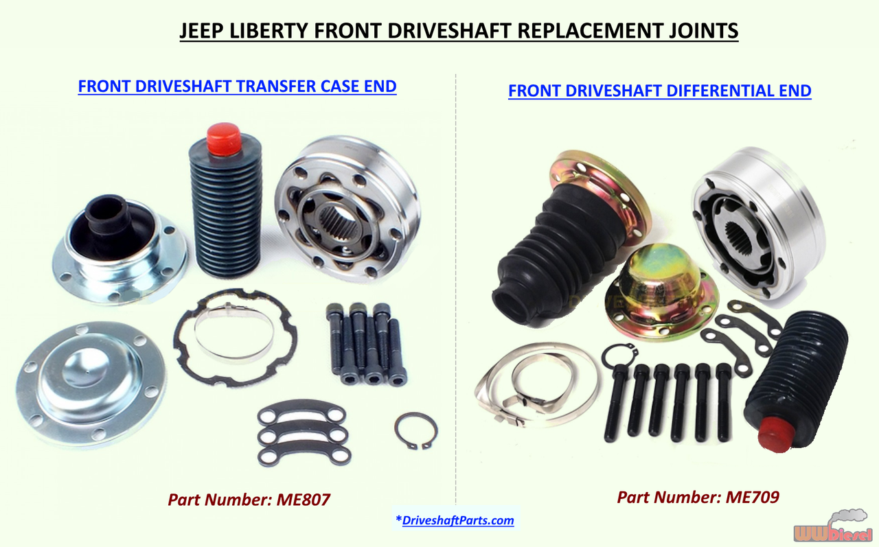

I saw the image of the "bad" front driveshaft head/joint in the first post. What does a good one look like?
Where does the boot in the image at https://www.driveshaftparts.com/index.p ... arch=me807 go?
KJ 2005 Jeep Liberty Renegade
The boot pictured goes to the rear, transfer case end.
Front Differential End:
Rear Transfer Case End:
Picture of Complete Front Driveshaft:

davidg91 wrote:
Oh, is the black tube with the red top in the picture actually the grease, not a boot for the rear transfer case side of the front drive shaft?
It kind of looks like a boot....
Yes, it is the special moly grease to pack into the CV joint. :)

Just tap on the side of the CV joints with big hammer after you get all the bolts out; it will come loose.
Once you get it out, you can safely drive it around and see if the noise is gone.
See inclosed Picture for parts:
