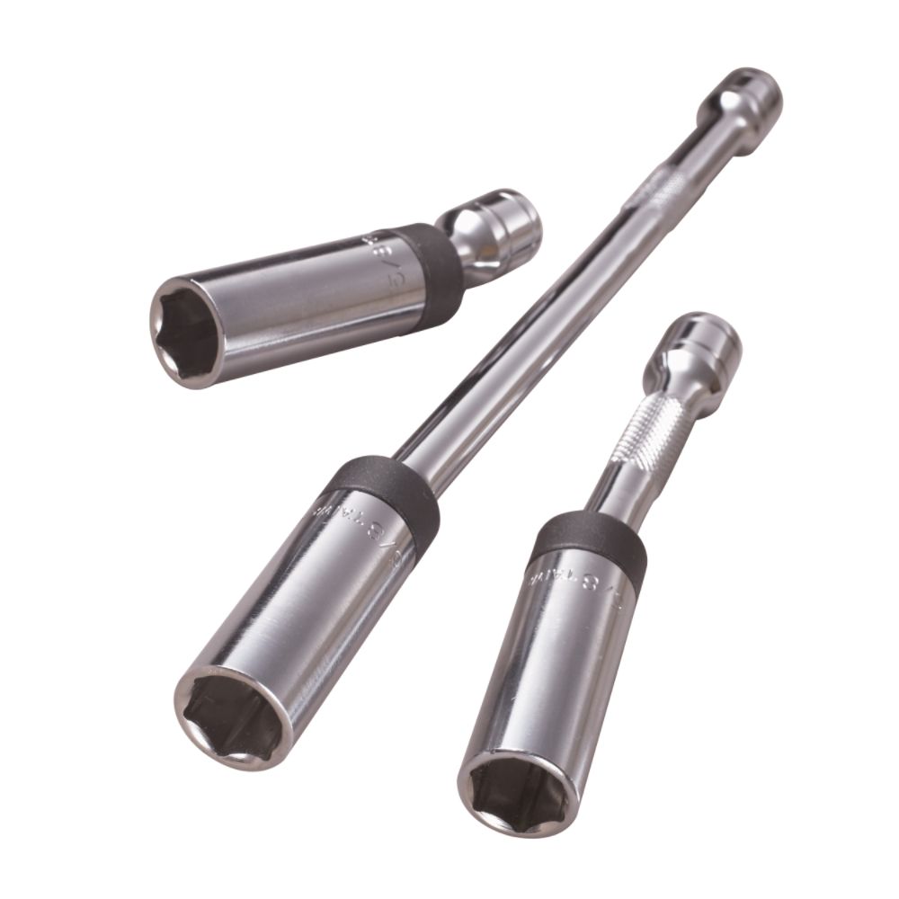

I don't think that part number is correct. At sears.com, it comes up as a "locking extension bar" which is just an extension bar with a ball on it. It doesn't have that slot that yours has.
I did stumble upon this though, which I guess is THE way to go:
KD Tools 3 pc. 5/8 in. Extended Universal Spark Plug Socket Set
Sears item #00942274000 Mfr. model #KDS41740
http://s7.sears.com/is/image/Sears/00942274000
http://s7.sears.com/is/image/Sears/00942274000?rgn=0,0,2500,2498&scl=10&fmt=jpeg
