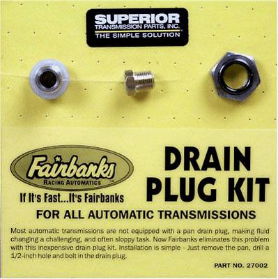

Now, my next idea is to drill a couple of holes in the new oil pan for a temp sensor and a drain plug.
Has anybody else done this mod? Do you think it's a good idea?

Dunno about the temp sensor, but I installed a drain plug on mine. I install drain plugs on all my tranny pans - makes it so much easier and cleaner.
I know that it's not necessary to change the tranny fluid that often but a drain plug would make the job less messy.
I assume that I should place my drain plug at the rear of the pan?
Leeann, could you tell us which drain kit you use please? I was just thinking about one yesterday, but I've heard they leak, so a verified one would be awesome :JEEPIN:

Um, when I find the box I'll let you know....
2005 Liberty Renegade, Bright Silver Metallic
:rockon:

Leeann wrote:
Picky, picky....
:BINGO: Many thanks!

So where does one drill the hole for this drain plug.
On the bottom of the pan?
With the transmission skid plate beneath the transmission it would be protected.

I have a pic of that...

Huh, not in the middle Eh?
I'm heading to Napa this morning to try and find a universal drain plug.
Thanks for the pic Leeann.

My hubby (HVAC master) looked at the pan, looked at the tranny and decided where it should go.
