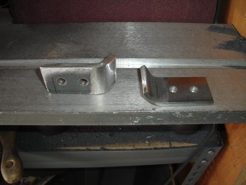

Here are the pieces we made for the job........

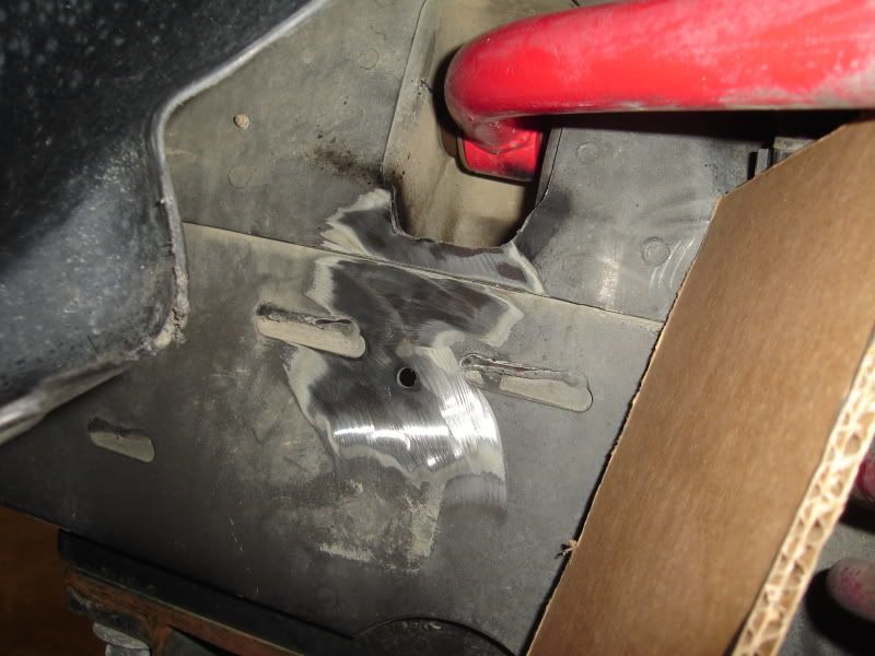

Here is the front UCA pocket preped for welding..................

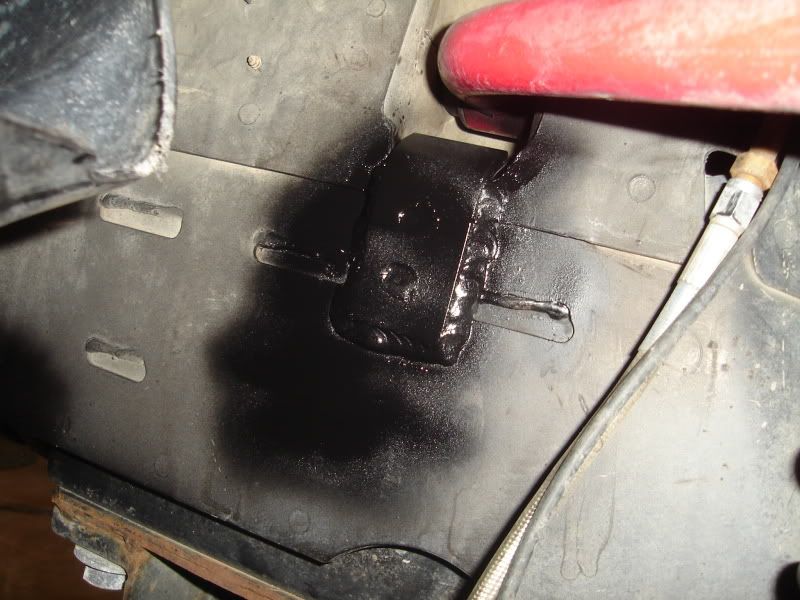

Welded on................

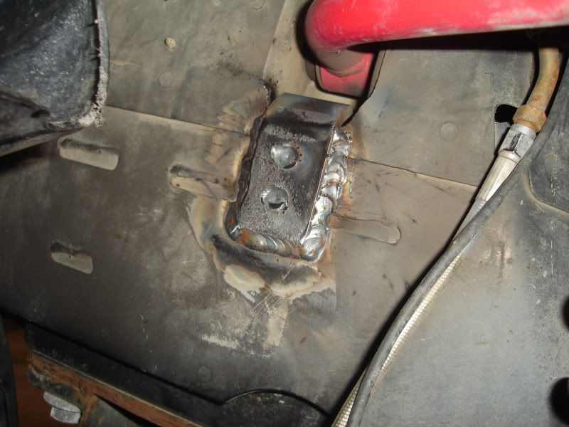

Finished.................
As you can see the 30 degree bend allows for a large contact surface as not to harm the UCA,we did add some rubber on top to add to the cushioning.

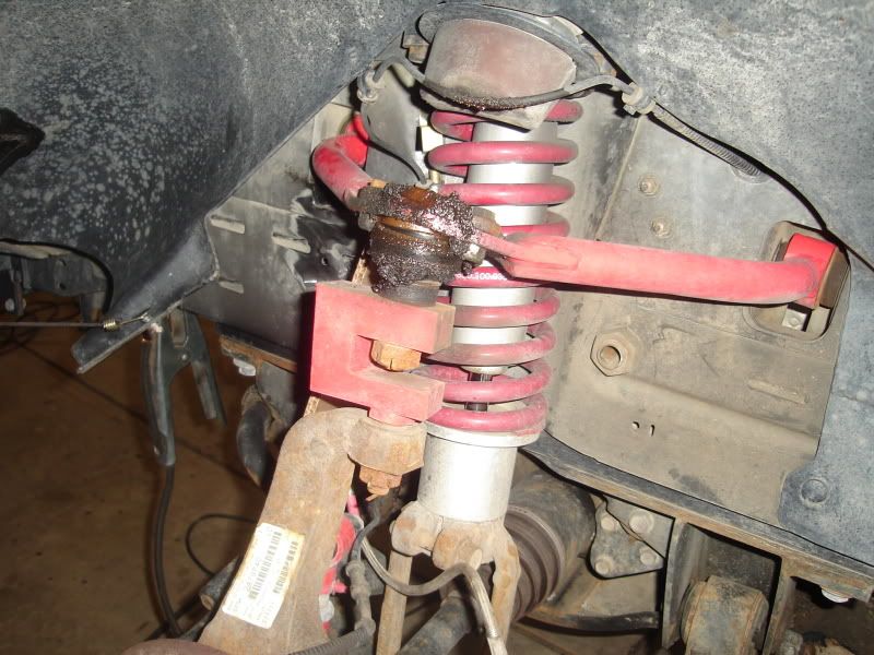

The pic below is how the UCA sits at normal rid height,kinda pointed way up.
