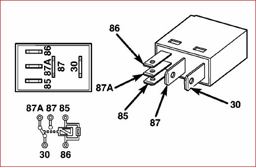

You can test the low beam headlight circuit by simply removing the low beam relay from the fuse panel and jumper pins 87 to 30, doing this should make the low beam headlights come on regardless of what position you have the stalk switch in. (See relay drawing below)
If they do not come on when doing this test, then the problem is in the wiring between the relay and the headlamps.
If they come on OK, then your problem is in the multi-function stalk switch or the wiring to / from the multi-function switch or worse yet, the Body Control Module.
