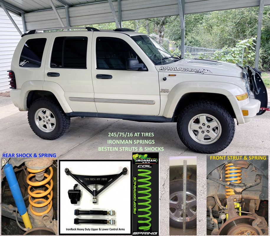

With a 2" lift and 1/2" clevis spacers up front providing 2.5" lift of lift, I am on my second set of 245/75/16 AT (All Terrain) tires on stock rims, no spacers, and have never had any rubbing problems during normal on road driving. :BANANA:
IronMan Springs, Bilstein Shocks & Struts, IronRock rear upper and lower adjustable control arms.
During off road extreme suspension articulation, you could encounter some slight rubbing at certain steering angles up front. :wink:

Mine is a diesel with Yeti's Stage IV Hot Tune, so there is no problem with power, pulls like a tank.
As to rubbing, you can do a little trimming and flatten out the pinch welds so they don't catch the tires when turning and flexing. :D
