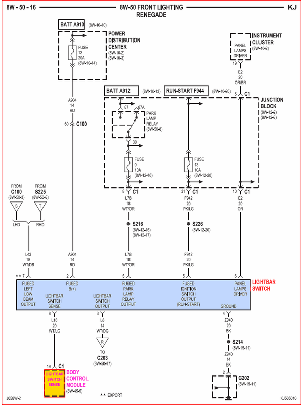

The Overhead (Roof) lights switch, relay, and wiring is not a simple circuit. See drawing below.
The light switch is also connected to the BODY CONTROL MODULE and has several inputs and output circuits.
The switch you see in the eBay link with the wiring is simply a switch that someone cut off the wiring and left them connected to the switch.
The wiring harness actually "Plugs" into the back of the LightBar Switch.
Without the proper factory wiring for the LightBar switch, it may be simpler to just wire and connect your own wiring, relay, and control switch like I did when adding additional driving LED lights. If you need more info, let me know I can post wiring information and diagrams. :wink:
The wiring schematic for the Overhead Roof lights can be viewed in the FSM in Section 8W, Page 50-16 & Page 50-17.
Link to view all Jeep KJ Factory Service Manuals online:> http://www.colorado4wheel.com/manuals/Jeep/KJ/
Link to 2005 Jeep KJ FSM:> 2005JeepKJServiceManual.pdf
See Section 8W, WIRING.

The Black wire is the ground wire.
There are four (4) white wires each with a different color tracer on them as listed below.
According to Mopar and the FSM, there is NO solid white wire listed.
See this thread in LOST:> viewtopic.php?f=3&t=80153
Pin Information
Cav Circuit Gauge Color Function
1 A904 14 RD FUSED B(+)
2 L8 14 WT/DG LIGHTBAR SWITCHED OUTPUT
3 Z940 20 BK GROUND
4 F942 20 PK/LG FUSED IGNITION SWITCH OUTPUT (RUN-START)
5 L78 18 WT/OR FUSED PARK LAMP RELAY OUTPUT
6 E2 20 OR/BR PANEL LAMPS DRIVER
7 L43 18 WT/DB FUSED LEFT LOW BEAM OUTPUT
8 L18 20 WT/LG LIGHTBAR SWITCH SENSE
WIRE COLORS
1. RD = Red
2. WT/DG = White with Dark Green tracer
3. BK = Black
4. PK/LG = Pink with Light Green tracer
5. WT/OR = White with Orange tracer
6. OR/BR = Orange with Brown tracer
7. WT/DB = White with Dark Brown tracer
8. WT/LG = White with Light Green tracer
LIGHTBAR SWITCH CONNECTOR (RENEGADE) - 8 WAY http://connectors.dcctools.com/home.htm
Full Repair Kit: Terminal Repair Kit
05019928AA
:google:
