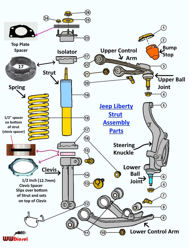

With that heavy of a front end you only have 1 option. (Well 2 if you want to do some fabrication).
You will need to go with OME 790 front springs and a shock/strut of your choice. The springs will give you the lift while the shocks will give you comfort. Just google the springs to find the best price. You can build the front setup yourself or take it to a shop and have them put toghther for you (note: the springs are very hard to compress and can't be done with those cheap spring compressors and can be VERY dangerous to do). All of this has been talked about before here on Lost and over at Jeepkj.com. Same process to lift a gasser will be the same for the CRD's. A quick search will net you what you want.
If you need more lift you can add 2 conduit nuts between the strut and the clevis (known as the clevis lift) for aproximit 3/4" to 1". If you go above 2.5" of lift you should also change the upper control arms for JBA upper control arms to get the alignment back into spec.
For the rear, you should change out the stock boomerang for the an adjustable rear upper control arm from iron rock. It will help you get your rear pinion angle back into alignment.

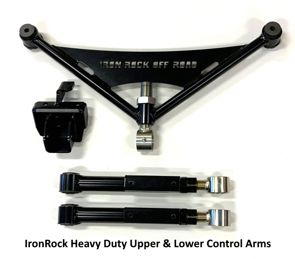

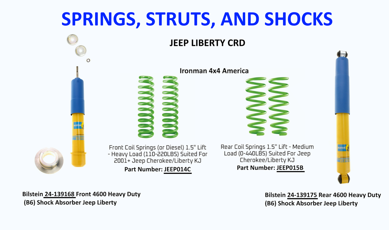

IronMan 4x4 or OME springs on front and rear.
Bilstein Struts/Shocks front and rear.
IronRock control arms on the rear. Upper and lower.
Cry once and be happy for years! Good handling, riding and reliable suspension systems are not cheap! You get what you pay for..... :wink:

Thanks for the response. Looks like I'll go with the OME Heavy springs front and rear, haven't decided on which shocks yet, and I will probably go with the RI upper control arm. How do you determine the adjustment on the aft link?

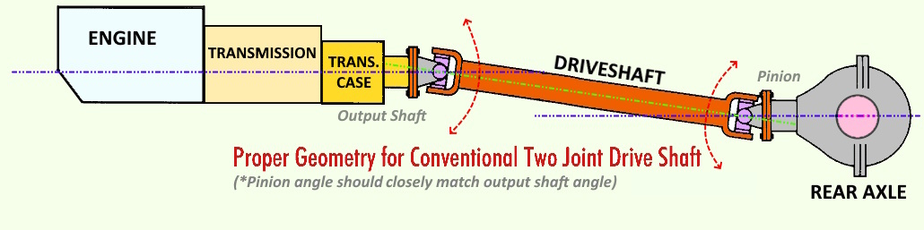

Measure pinion angle and adjust to match angle on transfer case output shaft.

Thanks for your suggestions. I purchased the OME front 2790 springs and the OME rear 2948 springs along with isolators and shock mounts. I went ahead and with the Nitrocharger Plus shocks and was disappointed that the lower spring cup was too small to support the 790 springs. The springs were just barely supported. There is no mention from ARB that the 790 springs will not work with current Nitrocharger 63069 shocks. It appears that the Bilstein's have larger diameter lower spring cups to support the lower end of the 790 springs. Now to find a set of four Bilstein's that are in stock and not have to wait on the backorder.
Once I get this done I'll work on the adjustable Iron Rock rear upper and lower control arms.
In stock and available on Amazon, but price is a bit higher than most other online retailers.
Bilstein Brand: 4600 Heavy Duty (B6)
Part Number Position
24-139168 Front
24-139175 Rear
Found Bilstein's in stock on another site for best price:
$25 off orders of $249+

I got the set of 4 at ID Parts and were in stock. Once I get everything installed, I will have to add all of my mods to my signature.

I got my parts and destroyed my spring compression tools trying to compress the springs into strut assemblies. Who makes a spring compressor strong enough to safely compress the OME 2790 springs? Once I lowered the lower control arm to replace the CV shaft i discovered that my ball joints are in need of replacement as well. Who makes upper control arms with the clearance to avoid rubbing the springs? I guess I'll replace the upper and lower control arms along with new ball joints and tie rod ends.
Thanks for everyone's help.

The 790's are to stiff to use the small spring type compressors. You'll need to take them to a place that have the wall type compressors to build the strut assemblies.
For the upper control arms, the only ones and best to use are the JBA upper control arms. They have rebuild/replaceable upper ball joints, provide the clearance from arm to spring contact (up to 3" of lift), and can get your alignment back to factory specs.
There are others that "copy" the JBA upper arms but have installation fitment issues and of course customer service is nonexistent. JBA's have lifetime warranty and their customer service is top notch.
Totally agree! The small cheap clamp-on type spring compressors can be extremely dangerous when used on some heavy duty type springs.
I cannot stress enough: These tools are extremely dangerous and can cause severe injuries, including death, if used improperly or if they malfunction.
Take your old and new struts to a shop with a proper professional spring compressor and let them swap them out for you; it will be a very wise decision.
The transition from potential energy to randomly directed kinetic energy is a horrible event to witness in person and can be life threatening!

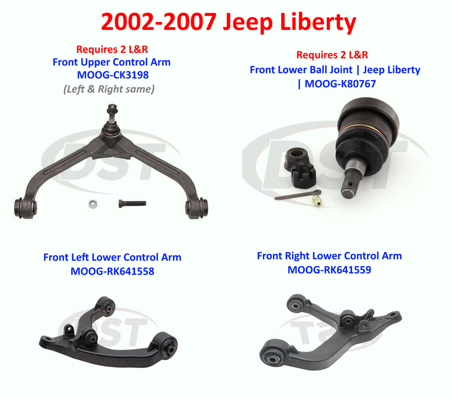

JBA's are next on my list along with rod ends and lower ball joints. Is there a better lower control arm or better lower ball joint to use?

Thanks , now to find a shop that is willing to build up my strut assemblies.
Greaseable Moog K80767 is what I used when i refreshed my suspension. Make sure you orient the beveled face/grease port to the rear of the jeep so you can grease it when the wheel is on.
With all the work your doing on the suspension, its going to feel like a whole new jeep. I did the same thing when I installed my lift. My thinking was while it was apart, might as well replace everything so i don't have to do it again (diff seals, ball joints, all the bushings, cv axles, inner/outer tie rods etc). Did the work myself and saved a bunch and learned more so if I break on the trail, I would know how to fix it enough to get me home.

MOOG Ball joints and Control Arms are your best option. You can purchase just the lower ball joints for the steering knuckles and replace them or in addition purchase lower control arm assemblies. *Lower Ball Joints must be pressed out of steering knuckles and new ones pressed back in. Upper Ball Joints come pre-installed in the Control Arms.
Front Upper Control Arm (*Same PN L & R sides)
MOOG Part # *CK3198 (w/greaseable Problem Solver Ball Joint)
• *Moog’s Premium line of control arms. Utilizing their “problem solver” technology, these control arms address common factory design issues providing a better than original replacement for your vehicle. CK or K control arms include ball joints that are powder coated metal with gusher bearings giving them a longer life. These ball joints are serviceable and have grease fittings. The CK or K arms also have the higher quality problem solver hard rubber bushings and a precise fit and form for easy installation.
Front Complete Lower Control Arms:
MOOG - Control Arm Left Lower Assembly (Part No. RK641558) [driver side]
MOOG - Control Arm Right Lower Assembly (Part No. RK641559) [passenger side]
Front Lower Ball Joints – Moog *K80767 (same PN L & R sides)
• *Moog’s Premium line of Replacement Ball joints, NO knuckle:
• Front Lower Ball Joints – Moog *^K80767 (same PN L & R sides)
[*Requires special tools to press old ball joint out of steering knuckle and press new ball joint into knuckle.]
• (^Denotes premium greaseable Problem Solver Ball Joint)
