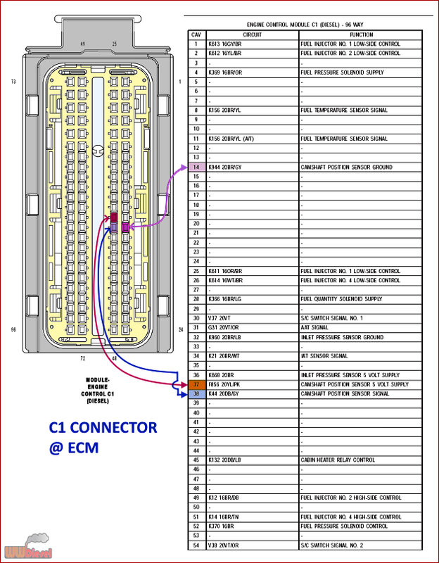

Check wiring, connector/pin fitment at sensor, and pin fitment at ECM for cam sensor circuit. See diagram
Check quality of ground at sensor and 5v power supply at sensor.
Other than the cam sensor, ground, power supply, wiring, and connectors, there is not much else to consider other than the ECM itself if you are still getting the P0340 DTC.

Thank you for the diagram, Hopefully I can take a look at it this weekend. The code does not come back immediately but it will come back after driving 15 minutes or so. As far as fuel goes, I added the electric fuel pump to the fuel tank a couple years back so fuel should not be an issue. But now that you mention it, I'm going to check the fuses to make sure the one for the fuel pump is good.
