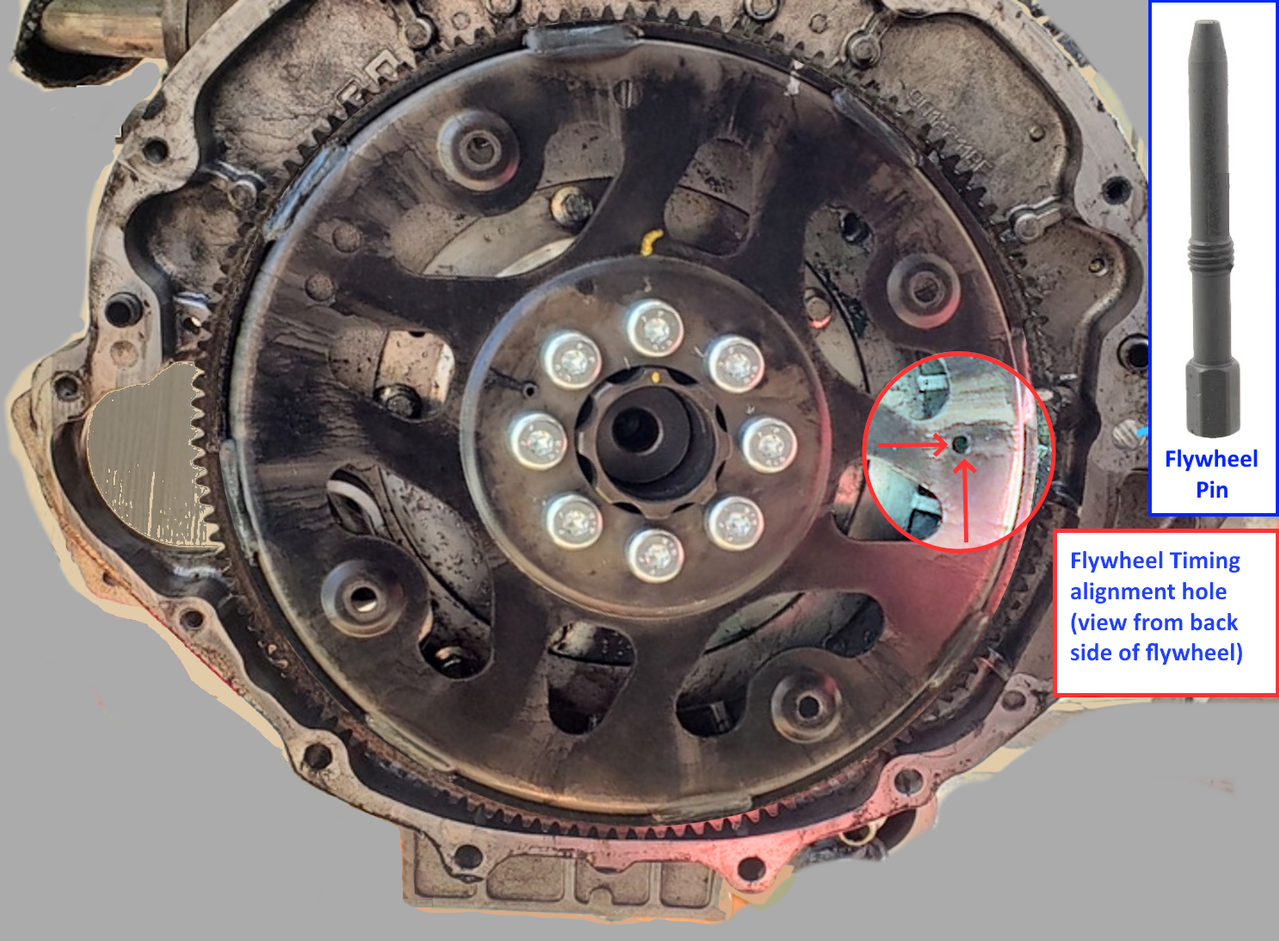

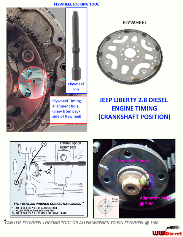

You did not mention the indexing and locking of the flywheel using the alignment pin. I still believe it is essential to install if you want accurate and a "perfect" timing alignment.
Just setting the crank pulley close to the 3 o'clock position and inserting an allen wrench in the hole to me is not precise alignment, has way to much wiggle room for possible error IMHO.
But to each his own if that what an owner likes, just not for me.
Thanks WWDiesel,
This time you have awakened me! I've been thinking that a half-tooth offset is no big deal -- but guess what -- 1/2 tooth is 3.75° !! That is quite a bit!
Now I have to get up the gumption to dig back in there and do it the exact proper way. Thanks for the grounding.

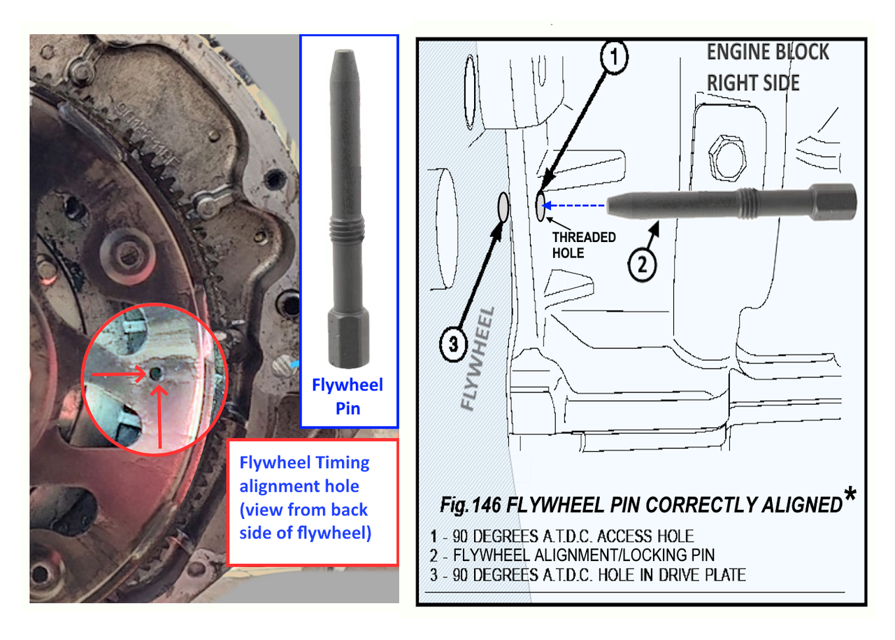

The hole in the engine block is threaded to accept the alignment locking pin which has matching threads for it as well.
The factory designed it this way for a reason; to ensure precise alignment when timing the cams to crankshaft.
Modified drawing.

Thanks for the info WWDiesel,
Something happened along the way when I put this engine / transmission together back in 2018. Today, I have bolt threads sticking out of the alignment pin hole. Also, I do recall that I wasn't sure about how to align the flex plate, so I just put it on. Even if I did manage to get that bolt out, there is no certainty that the flex plate hole will be in the right place.
The engine / transmission have been working fine, I just cannot use the 90° crankshaft alignment pin. So, I will have to position the crankshaft as good as possible with the crankshaft flange threaded holes and witness mark. This will get me closer than the method I've been using. As it sits now, the exhaust camshaft is 3.75° advanced and the intake is 3.75° retarded. That is enough of a mis-alignment to warrant getting back in there to correct it. If I miss by 1° then I'll still be better off.
Thanks for the wake-up call.
[Edit] As I recall, the flex plate does have a locating dowel pin. That should ensure the 90° alignment hole should be in the right place. ...for what it's worth...
Dean.

Dean, That is very strange indeed! That threaded hole in the rear of the engine block is NOT used for anything else other than timing alignment.
Why you would have put a bolt in it I have no idea. Was the bolt screwed in from the flywheel back side of the engine or was it screwed in from the front side of the engine.
