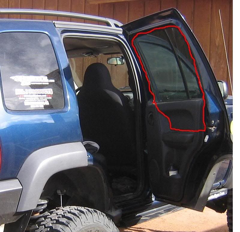

OK here's my take on the whole thing. I think it would be cool to do this so it wasn't QUITE as dramatic as an open wrangler style door. If you cut the interior of the door along the path that the armrests and controls take on the door it would let you keep the factory door mechanism and the contour of the factory door. Here's an example of the cut line on a rear door:
The window would be removed but the outer frame would stay intact to keep the contours. The perimeter around that hole would be lined with snaps and a snap-on canvas safari door with a clear plastic window (possibly a zip-down window)
Soft door skin like this? (but with a bigger window)
From the exterior the cut would be approximately like this.... (I'm drawing with a touchpad so cut me some slack)
This would let you still get some open air and would make it easy to hang out the closed door when off-roading. If you sit in your KJ and imagine the door missing at the armrest it's quit a difference.
Just some thoughts....

For me, I would want to fab up some tube half doors and then have them covered in skins like the wrangler soft doors. But that is more work than I think I want to do. But then again if I trash more doors on a certain norcal trail up here then maybe I'll have to. :lol:

everyone forgets that the liberty is uni-body...the doors are a big part in keeping the jeep true...if you do anything it should be half doors...and keep the out side of the door so you still make a shell to help the integrity...i have seen alot of xjs poop pot windows befor...yes i also know that the kj/kk are alot stronger uni-body also
