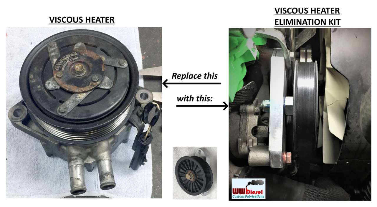

Ditch the metal fan blade and upgrade to the GM 11 blade lighter plastic fan and the larger heavy duty V8 fan clutch. Moves a ton more air flow through the radiator stack. See picture 1
As to the viscous heater, I can provide you with a delete kit that gets rid of the viscous heater but still allows you to use your stock serpentine belt and keep your mechanical fan. See picture 2

Picture 2, Viscous Heater Delete

I know about your offer of Viscous Fan idler pulley replacement. My choice is to remove the viscous fan and gain space and accessibility around the front of the engine. Thanks for the offer and reminder. :)

I ordered a Viscous Heater & Mechanical Fan Delete Kit by mistake. Returning it to IDParts means losing 10% plus paying shipping back to them. Doesn't seem worthwhile, so if anyone wants it, contact me via PM to arrange shipping to you. Mail a USPS cushioned bubble envelope to me with postage already on the envelope.
Now I'm searching for the right parts to delete only the Viscous Heater but keep the mechanical fan. Measured the length of the serpentine belt and found it needs a belt about 12" shorter. NAPA says the original CRD belt is 113", so that calls for a 101" belt. I bought a 101" belt and a 100" belt.
Next part to find is the idler pulley #1 in the image.
I've been searching but so far have not found the right pulley. Anyone have some suggestions?

Closes pulley matches to your quest I have on file.
Pulley
Manu. Material PN OD Dia. Width Bore Flanged Y/N
Gates Thermoplastic 38009 76mm 25mm 17mm Y 6 grooves
Gates Steel 36157 87mm 31mm 17mm Y 6 grooves
Dean, I still have a big problem with the design you posted due to the huge loss of belt contact surface to the both the AC pulley and especially the crankshaft pulley. Not to mention the loss of the cooling fan.
I think this is going to cause a several belt slippage problems under load.
That is why I designed and sale the viscous heater delete kit which retains the OEM belt length and all belt contact to pulleys remain the same.
You simply completely remove the viscous heater and replace it with an in-kind size idler pulley and bracket (see picture) and this allows you to keep your mechanical fan in service if you want, or to completely remove it, you simply screw the fan and fan clutch off the hub pulley. :D :2cents:
