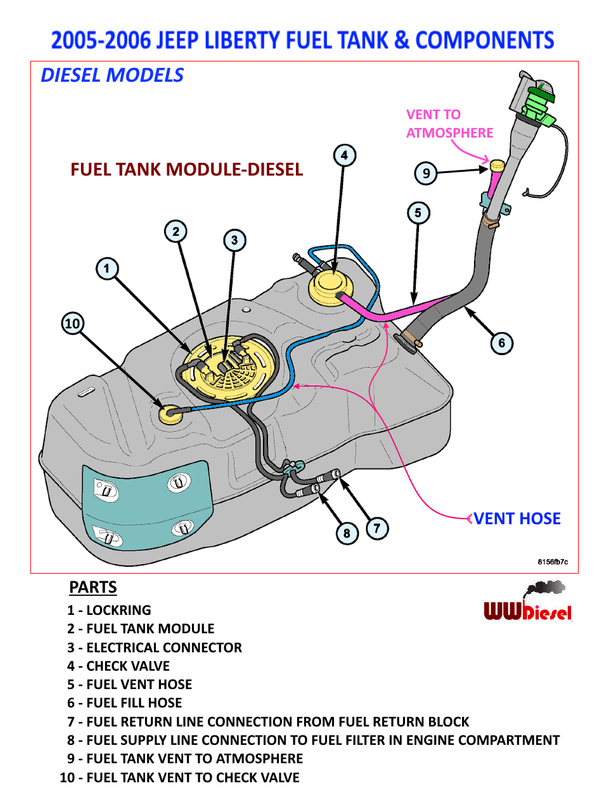

Getting ready to get a safety check, which it failed on Monday. Had to fix the license plate light, the left marker light, and the emergency brake not holding while in drive & reverse. My last post was about the marker light, the license plate light was simply replacing the bulb, and the emergency brake was more than just an adjustment.

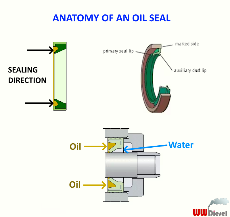

Replaced the emergency brake shoes, but I didn't expect to have to remove the rear axle shafts to do the job. That turned a 2-hour job into an all-day job. It's done now.
Good thing I had to open up the rear end because the gear oil was milky. Found the air vent from the top of the differential was hanging down and letting water in. Drained a whole gallon of fluid, but only took a half gallon to refill it.

There is a breather on the fuel tank that is down low, just strait out of the top of the tank.
It will suck moisture & dust into the fuel.
I put an extension on mine up to next to the filler cap.

I got tired of working on the Jeep all the time, had to take a breather. Working on the Jeep more than driving it goes against my grain. It should be more reliable than this.
Thanks for the good idea. I do remember seeing that fuel tank vent tube quite a while ago. I should extend my differential vent tube and attach it to the fuel vent tube.

Diagram of fuel tank vent system.
What is that short hose coming out of 4? Next to the hose to 10
I first discovered it because when I overfilled the tank, diesel leaked out of it.
That is the hose I have extended up to next to the cap.

Not sure, looks like a short hose with a check valve on the end of it? :?
Maybe someone else can shed some details on it.
Yes, there is a plastic check valve on it.
I think it is some sort of overflow.
It collects dust and becomes inoperative. Allows flow both ways. It is very dusty around it if you drive on dirt roads.
If you drive through water or even in heavy rain, moisture will contaminate the fuel in the tank.

Thanks for the banter guys. There was a lot of water in my tank when I got the Jeep, and there was other evidence of this vehicle being driven in water. That would be a clue. Now my differential has been getting water in it, although it could only be from rain splash during my ownership.
Dean.
If the vehicle was driven or allowed to set in deep water long enough, there is a short vent hose on top of the rear differential that could allow water intrusion into the rear differential.
Also, the pinion and axle seals are designed to hold oil in the differential and do not do as good a job in reverse keeping water out of the rear end especially if the sealing lip is worn with age. If the rear axle sets in deep enough water long enough, water could creep past the seals.
