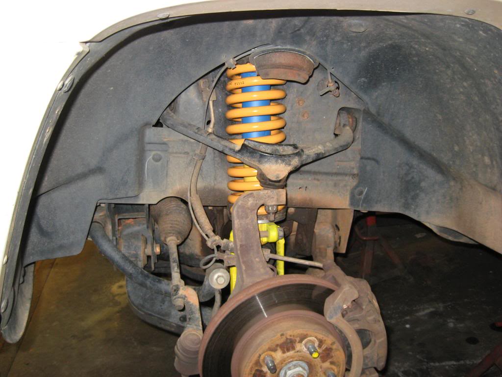

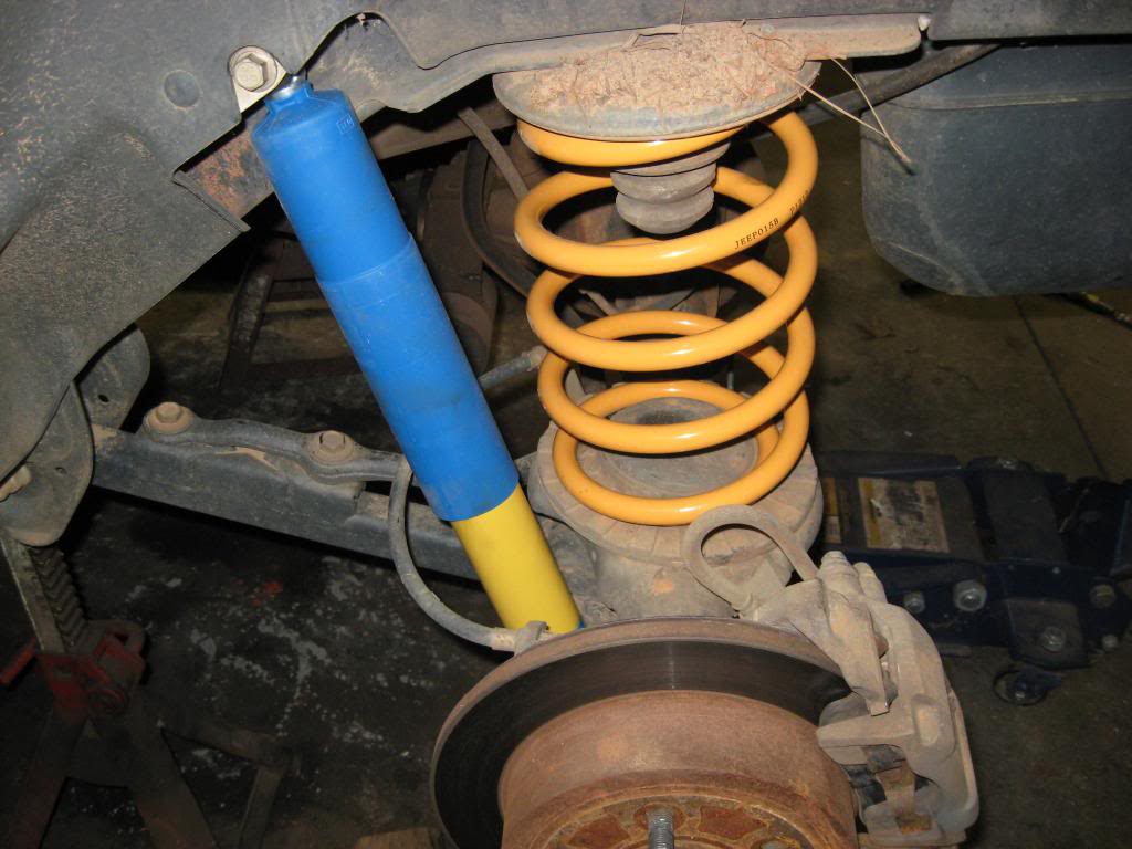

I have had the Ironman springs installed since 2014 along with 1/2" clevis spacers up front along with Bilstein shocks/struts. Gave me about 2"- 2.5" of total lift up front. A really good setup! Very pleased with the results, ride, and road handling characteristics.... :D
*They have changed colors since I purchased mine, but they still work perfect.
Struts/Shocks:
Bilstein: 4600 Heavy Duty (B6)
Part Number Position
24-139168 Front
24-139175 Rear
Ironman Springs
Front: JEEP014C
Rear: JEEP015B
