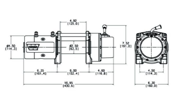

Ok so new question. Do you think this will fit the TR Bumper? kinda trying to save on weight? its 54lbs as opposed to the 85-90 lbs of the 9.5 etc.

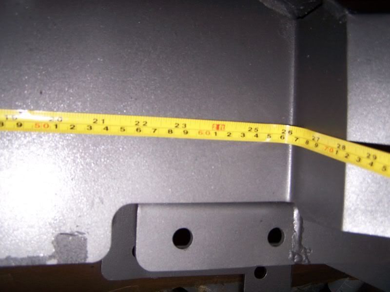

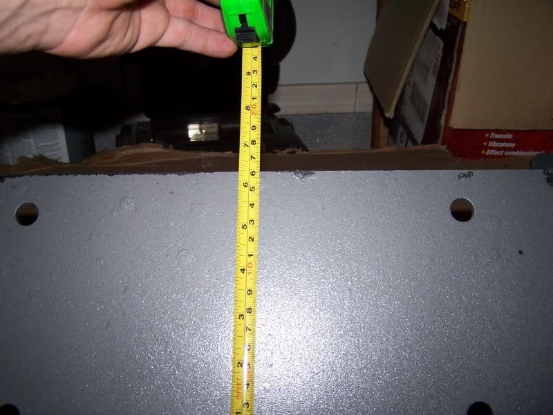

Looks like it should fit. Aren't those holes in the bumper aready 4.5'' apart?(first measured picture)
hmm... let me check.....
2016 JKU RUBICON
other mods coming soon...
PostPosted: Mon Nov 12, 2007 8:28 pm
Posts: 2133
Location: Sin City USA
yep :)
10.0" x 4.5"
2016 JKU RUBICON
PostPosted: Mon Nov 12, 2007 8:31 pm
Posts: 1251
Location: Sparta
It will fit, you will just have to drill new mounting holes for it.

I would recommend the Warn M8000 winch. Great little winch that holds twice the line. If weight is an issue, the 9.0RC is 54lbs with the synth line, and the M8000 is 80lbs with cable. Synth line only weighs about 3lbs. You swap the cable to synth, the compared weights of the two winches couldn't be off by more than 5lbs. They are almost exactly the same except the spool on the 9.0 is shorter. The M8000 is also $505 with free shipping: http://www.winchdepot.com/PDT57613.aspx then you get some synth line for about $200, and you save about $4-500, save weight, and don't lost length of line, and you won't have to drill a new bolt pattern in the bumper to mount the 9.0RC.
