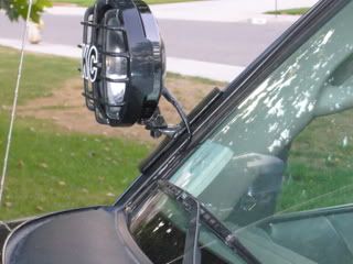

BTW, on your first pic I see a set of lights up by the window. How did you do that, got any more pics of that!?

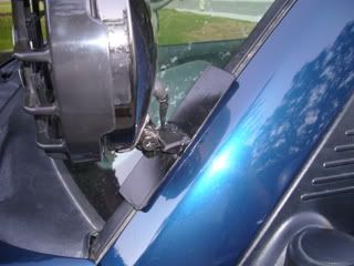

Also Like someone else asked, where did you get the light mounts for the pillars!!! THose are outstanding! I know RL makes em for the XJ maybe if enough of us want them we could get some made up for our rigs?

ill try to answer as many questions as i can. like i said befor this is the first-run prototype and i am trying to make this apeel to the masses. please keep in mind that the mor labour intensive these are to make, the more they will cost.
the bumper mounts to the stock tow hook location, crossmember bolts(front) and the end treatment plate (1/4")(not shown in pix)
i will add two more mid span and 1/8"-1/16" plate inbetween to cover the uni-body, as well as extend the ends out to the end of the fender flairs.
most imprtantly, these will be build to order. this means if one of you wants a stinger top tube, you get a stinger top tube. basicaly i can customize the final produt to your individual liking.
sport & kolesy, these are for you two..
price on these mounts is $45.00 plus shiping pm me for mor info.

ORM, those mounts look real nice. How difficult is it to mount them? Can I get a picture with the whole jeep so I can get a better idea of looks.

sport, sorry, i don't wat to give away my 'trade secrets". pm me for more info and ill send you some more photos
