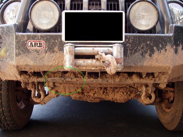

The 05-06 version does have High-Lift points incorporated into the design and a washer bottle/horn shield on each side. To prevent the bottom edge of the bull bar from bending, I'd add more vertical steel pieces like those that compose the High-Lift points. You can see the bottom is bent where the mud is removed in this picture:

Unixxx, I also had the lower part of my ARB bend into my winch cable. My buddy straightened it out and welded a piece of 1/4" angle iron over that section. It hasn't bent yet!
I submited an E-Mail to ARB about 2 yrs. ago on this issue. Their reply was: we'll submit it to our engineers for consideration.

Seth: I'll add that even though the bumper only weighs 85 pounds the winch will weigh that much as well.
