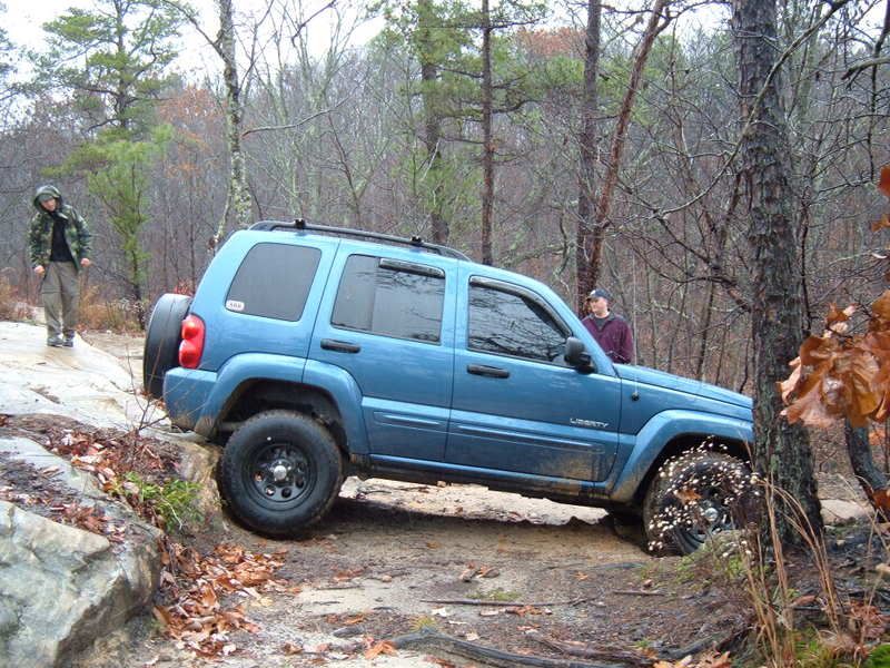

Fuel tank skids bend fairly easy. Eddo has the OME hd springs, air bags, and two extra isolators, so he has alot of lift in the rear.
The corner of mine bent in this pic:
There wasnt much weight on it at all. Thats the only time Ive ever hit that skid. The front suspension skid and the tranny skid is used the most. Ive hit my tcase skid, but it just barely took the paint off and probably would of been fine if it wasnt there.

jerbacher wrote:
Is that at Livingston?
This is the hard line. The bypass is much easier. We were trying to take the most we could.

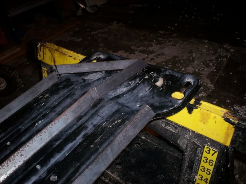

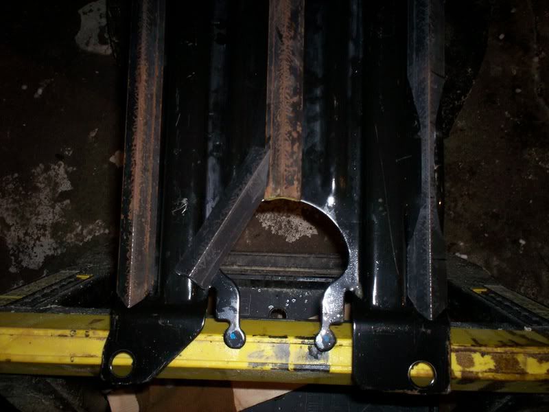

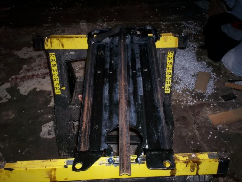

Well I havnt gotten much time to work on this little project. But I did get started a bit this week. I am going to run three lengths of 1"X1/4" angle iron down the length of the skid one on each side and one down the middle. It looks like I will only lose about 1/4" of clearance the way I have it laid out. I am going to angle the angle iron down & inwards at the back where the skid takes that funky dip to meet the t-case skid so it wont interfere with the bolt holes in that area. I will try to get some pictures this weekend but here is the basic layout.
Bottom View
FRONT
REAR

Here are some pics of what I'v got laid out. Still a bit of cutting and grinding to do, but I have only been able to work on these on my lunch breaks etc.
That middle piece will be cut off so that I can get to my oil drain plug and will look something like this when I am done. I will box all corners and taper any edges to meet the contour of the skid.
A few more pieces and I will be ready to start welding. I will probably add a piece of 1/8 flat plate to the front mounting points to overlap the angle iron a bit drill a few holes in it and weld through to the stock skid. That should stiffen the front up a bit. I will get some more pics when it looks better.
