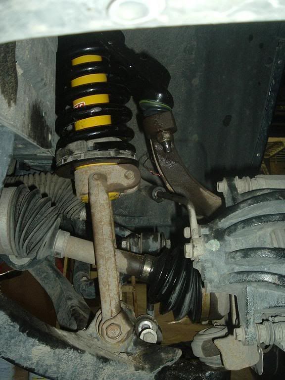

Jeepjeepster wrote:
If you look in the picture that tjkj2002 posted, the bottom plate gets clamped into the clevis/fork. :wink:
Why do you keep winking at me? I'm not sure what kind of strut you are running, but my fork bolts onto the strut. There is no "bottom plate". It's part of the strut. The person asking the question was running an OME strut like mine.

Does the Rusty's suspension kit come with new spring isolators or are the old ones reused?
DaveKJ02 wrote:
She has the top plate, strut and spring. What bottom plate are you talking about?
The old ones are re-used.

Here, you can see in these pics most of the parts you'll need to re-use:

PostPosted: Mon Mar 26, 2007 8:50 pm
DaveKJ02 wrote:
This is correct, but there is still a plate on the bottom of the shock that holds the spring. :wink: :wink: :wink:
