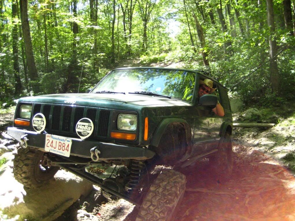

Do you work at rock lizard fab?? I've got a rock lizard fab front bumper!!
Yep,that bumber does look familiar.
