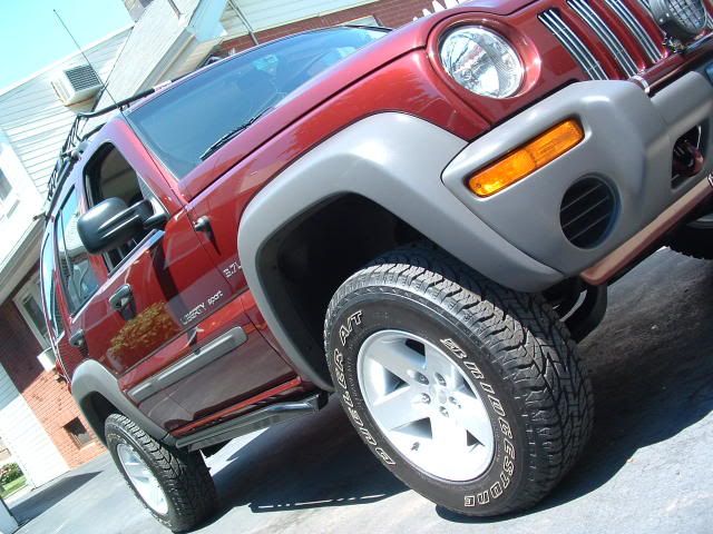

PostPosted: Sat Jan 10, 2009 8:09 pm
Joined: Fri Jun 06, 2008 11:40 pm
Posts: 630
Location: Southern New Jersey
RRO sliders :)

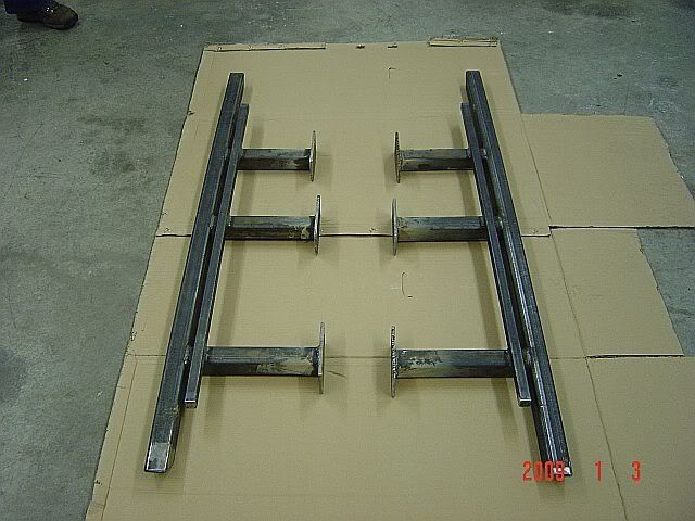

$40.00 in steel and had a friend weld them up for free, will be mounting them soon!
Winner! That is a crazy deal.

jsc7002 wrote:
what thickness is the main tube?
I had all of the metal bought to make some all out of 1/8" for about $40 too but then I got a deal to good to pass on some 1/4" rock rails :D
Not sure but they weigh about 45lbs each. The guy that put them together for me works at a shop and all I had to pay for was the two 60" 2x2 pieces and the two 48" 1x1 pieces. The rest was scrap they had laying around the shop.

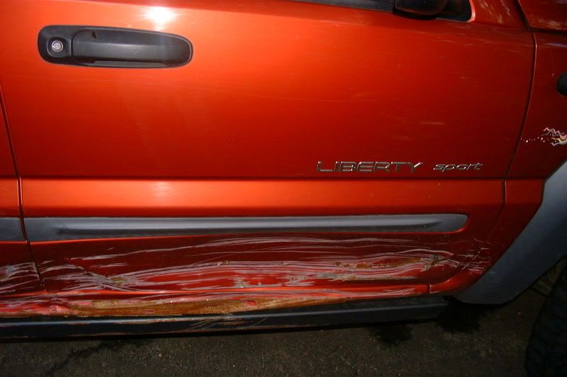

I had the 1st production Rusty's rock rails (2nd set back in '02) They stood up for six years of bashing... That being said - it would be nice to have a nerf bar like the RL especially after the carnage a few runs ago...
Dang.............................. :shock: That hurts just lookin' at it. I've seen some of the guys with the RL sliders wheel, and without that outer rail................well, they would have been lookin' just like yours without it.
SO how exactly do you mount those? Do you bolt it through the tube frame or use U bolts like what they use on the running boards?
Do you have a pic from underneath with them mounted? It would be very helpful...just a few more add-ons like this and I'll be out of my newbie suit! :lol:

BjBnet wrote:
LIV42DY wrote:
RRO sliders :)
Thanks
most all mount through the pinch weld in at least 5 or 6 places then bolt into the frame with like a self tapping bolt. Boulder bars for example have 3 legs like 501s above with 4 bolts in two legs and 3 in another leg so 11 bolts total into the frame, then those through the pinch weld

Yep, what Tom said!
I don't have them mounted yet, but that's how I'm doing it :D
