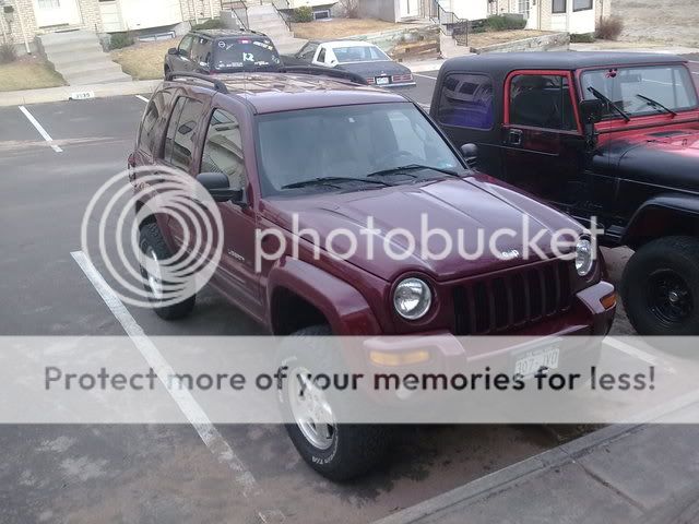

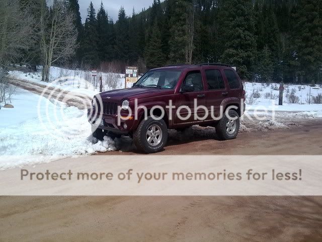

KJ in front of the house

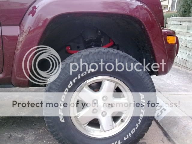

Right front tire

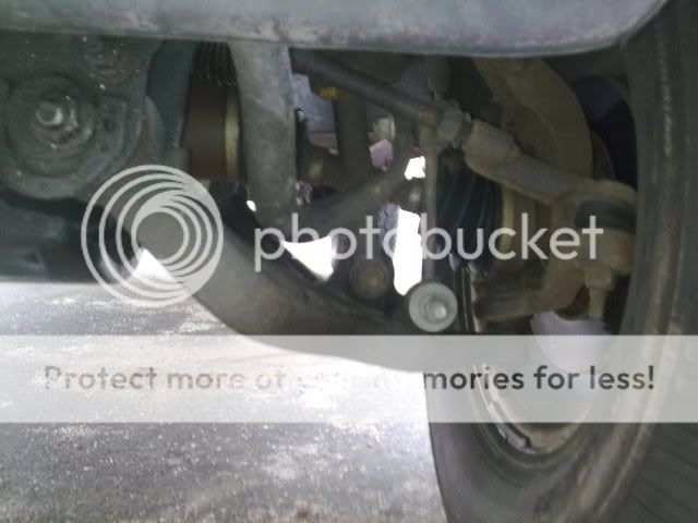

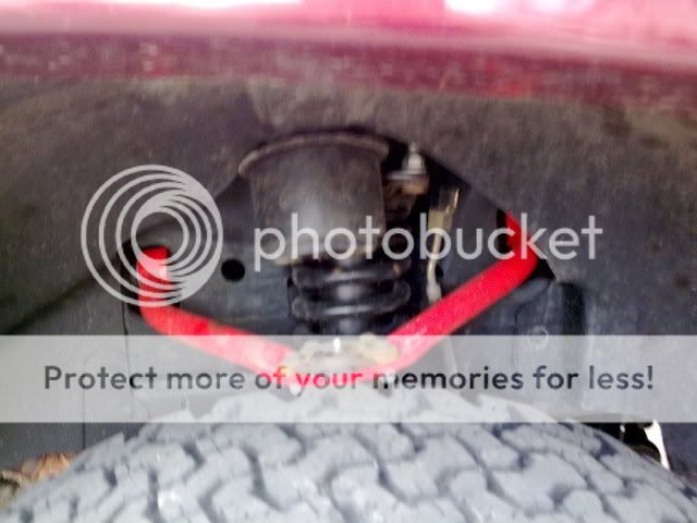

Close up of right A arm and strut/spacer assembly. I will change out the Tera Flex 2 inch bump stops for stock again because the A arm sits so high.
Left CV axle

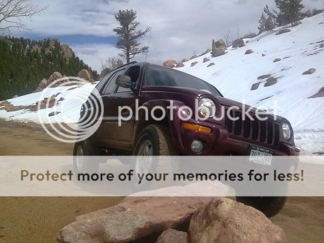

On a dirt road just for fun

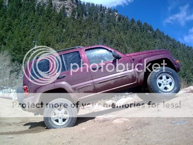

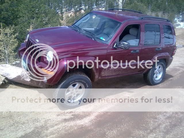

Front tire on a rock. The Right tire would have been stuffed in the wheel well more but I still have the Tera Flex 2 inch bump stops installed and it was hitting the stop here

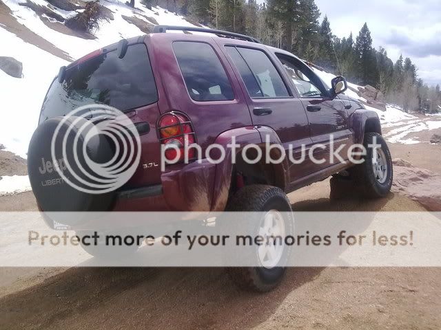

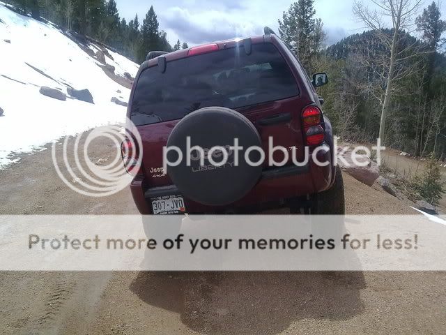

Rear corner view
Rear

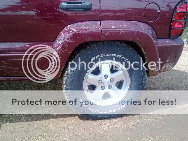

Left rear tire

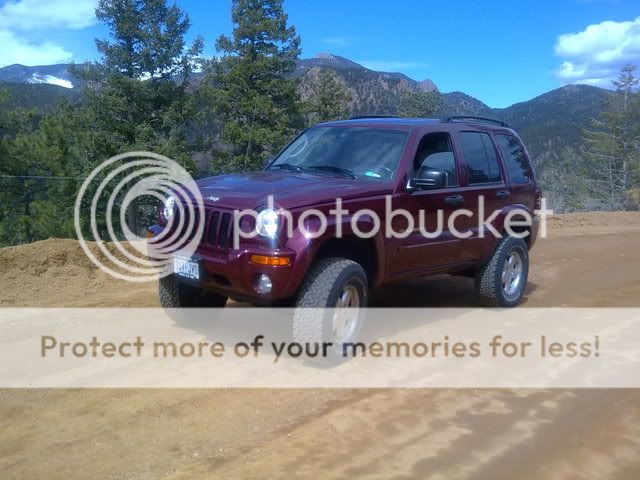

Near a trail head
On a slight incline
So far the lift setup has been working well. I have to install some isolators in the rear to level out the lift. There are none right now. I have yet to install my new rock rails as well. Diffs are open.

I understand the reason for keeping the larger bump stops with the Tera flex spacers. I would keep them if my A arm were a little lower.
The A-arm spacer I'm using (not really road ready yet) has my a arm sitting an inch or two higher than I would prefer. If the arm were lower then it would cause too much spring compression and need the extended stop at full articulation. Now it doesn't come close because of where the arm is.
