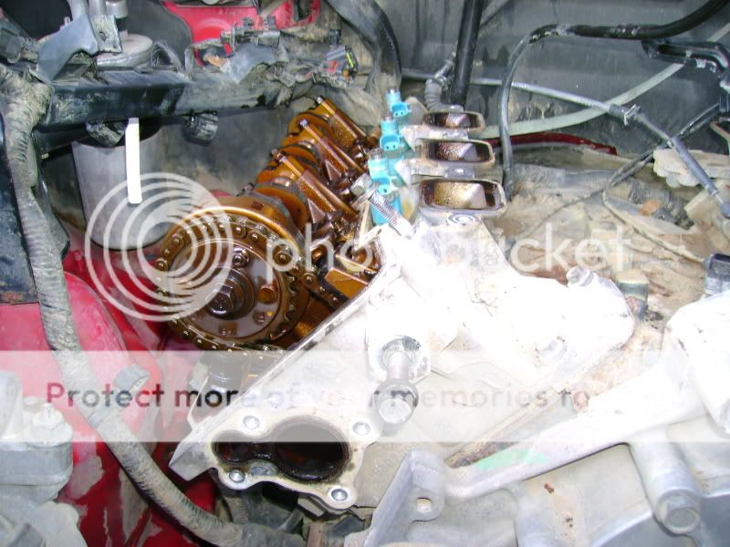

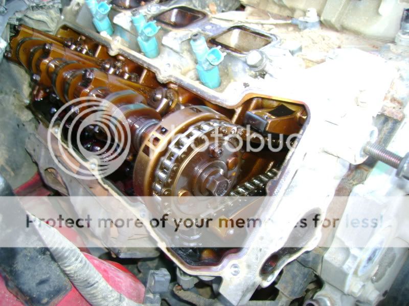

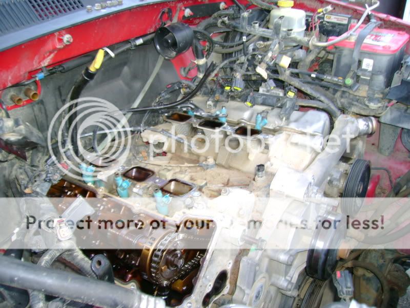

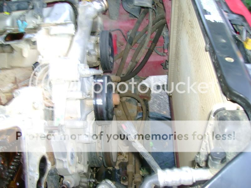

Started the teardown this afternoon with the help of BugginKJ. Got all the accesories pulled loose (AC, PS, Alt. , Fan Shroud and fan). Got the fuel rails off, Intake removed, valve covers off. Noticed a nick in the camlobe on cylinder 2. Don't think that caused my problem, but it's still A problem. Will pull harmonic balancer and timing chain cover tomorrow. Then I/we can mark/stabilize the camshaft and timing chain and pull the head off to check that #2 cylinder and try to figure out what exactly happened.
I didn't grab the camera until we had almost everything off :oops:
More tomorrow in the continuing saga of Wildman's KJ
