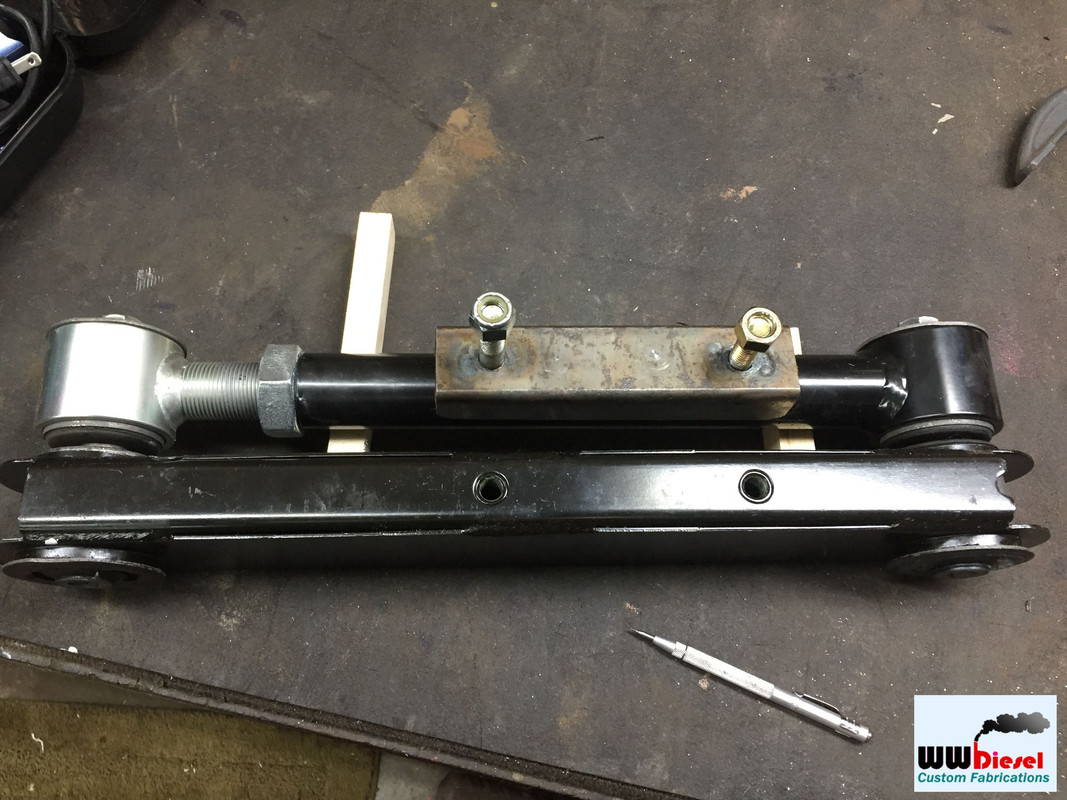

And the fun begins,
rear lower adjustable IronRock Control Arms arrived today, they are massive and much heavier than stock arms!
First impression looks like it is going to be easy to add some sway bar mounts to them. I think I already know what to use.
I will post once I get it all figured out and welded up.
Meanwhile,
This is what they look like side by side and end to end next to the thin flimsy Mopar recall arms.
They do have the same bushing widths so it is a simple drop in replacement.

Posts: 7390
Made some progress today on designing and engineering sway bar mounting pads to new HD IronRock Lower Control Arms.
Will install arms on my vehicle and share pictures tomorrow.
pictures.
1st Fitment
Brackets before welding to arms.
Brackets welded to Ironrock Control Arms, painted and ready for install.
