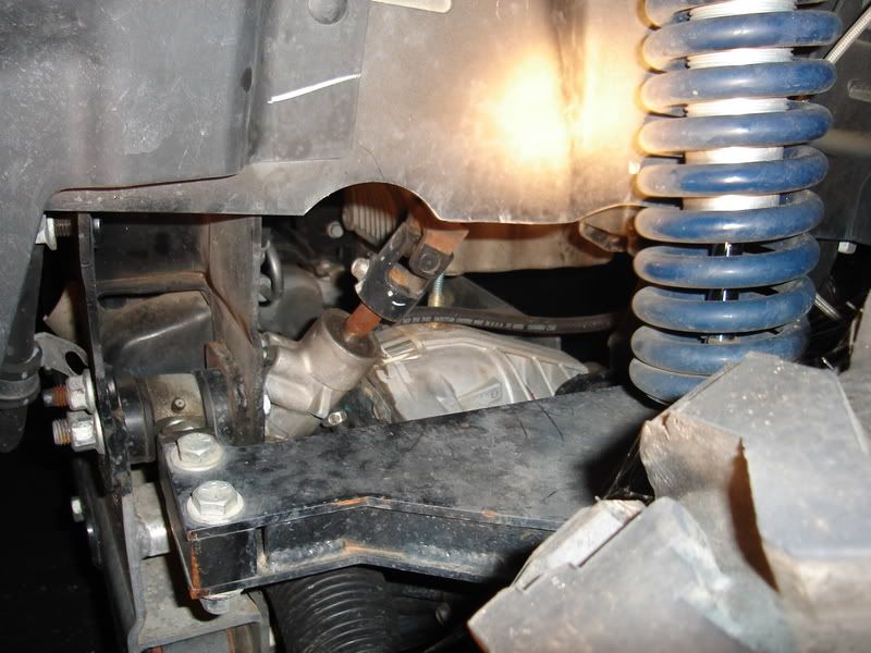

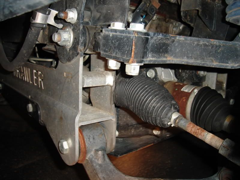

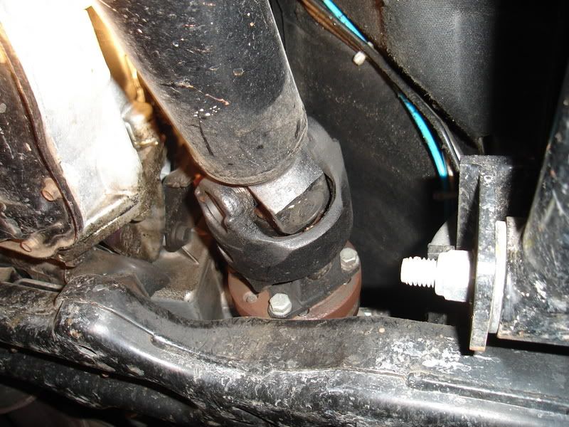

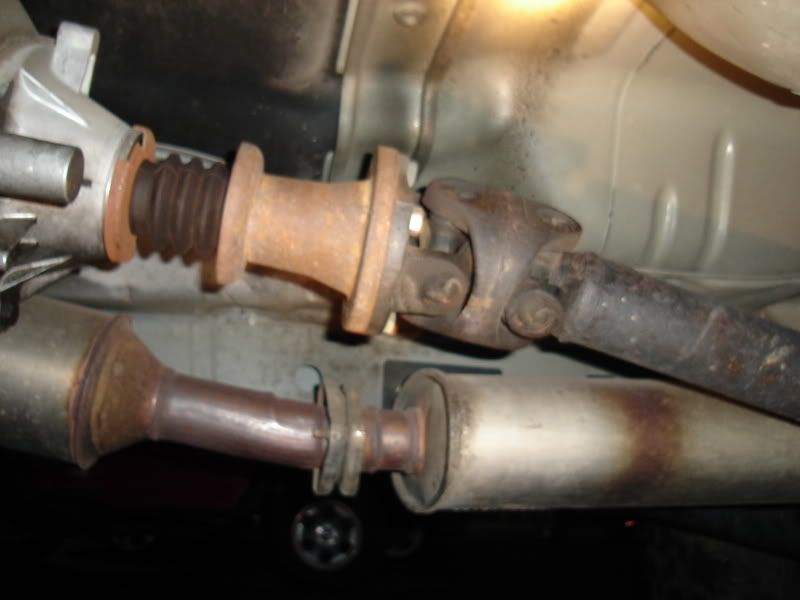

I took 6 pics and you realy cant tell whats going on. here they are anyway. this one shows how much lower the tie rods come out from under the frame.
Image This one shown how much of the steering shaft is now visible if you look behind the tire. Image Front driveshaft cv. Imageand rear cvImage

I did gain good ground clearance because my cv angle was negative of what u want. The front diff was lower than the center of the tire on my liberty. Now the cv is angled about 15-20 degrees pointing up towards the diff. I have not measured the ground clearance but maby later.

In that first picture, it looks like your boot is pushed up against the metal. Could lead to something serious down the road.

Interesting. So does the front coilovers mount directly to the upper control arm ? I wonder how the load transfer shock would cope with those arms long term.
Is that front main drop cradle made from Aluminium ? or is it Nickel plated laser cut steel ? Its weird how they run those front support arms that make it look like a SFA long arm from a distance! Were they part of the original 7up kit or was that one of your design additions/mods.
Looks good.
Thanks for the pics (but keep them coming, the more the forum can see this the more informed we are!! )
Cheers
Stu

The whole kit was 1/4 plate steel the upper a arms are RK design. Yes the boots re too close to the cradle Id like to find softer rubber ones that will conform to the space these are a lot bigger around tham they have to be. lucky I dont like mudding or my rack would be in trouble. Ill get it fixed soon.

RikMil, what is that spacer style thing you've got attached to your driveshaft, then Cardinal joint ? It loos like some sort of trumpet adapter thingy ? lol!!
Did the Driveshaft company do that ?
I'm about to find out this week how they will adapt mine. I want them to put it as close to the T'case output shaft as possible and lengthen the driveshaft.
