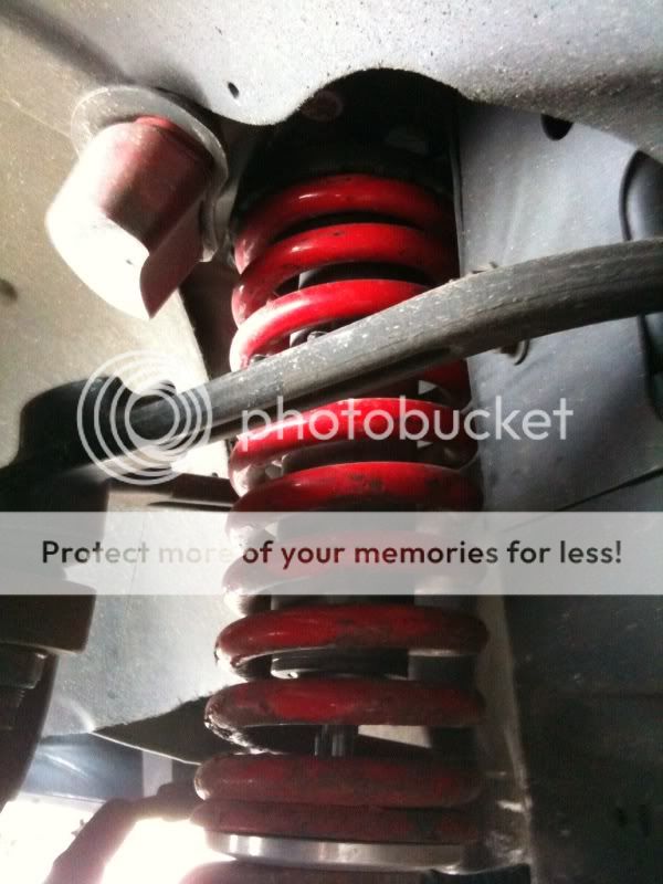

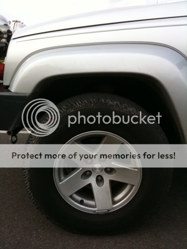

PostPosted: Mon Oct 19, 2009 4:19 pm
I respect Marlin, but would argue this point with him.
First unless you have one of the very first sets of Skyjacker coils then the spring rate is close to stock. You have added over 200 lbs with bumper/winch etc. Installing the Daystar leveling kit will work for a short time but in a few months the coils will be sitting on top of one another.
Pay now or pay later
You just ned to go to heavier OME coils ( since that is all that is available at this time) At the very least 927s preferably the 790s
x2 i had a Rough Country lift which was my first mistake. started sagging when i added the ARB and Warn so i replaced with stock CRD coils. very soon i was stacking those coils. get all coils and add a bit of spacers to it.
Im running OME 790 coils, 3 conduit nut clevis lift, and a rustys 1/4" upper strut plate. I have basically the same front end as you and Im sitting at about 23" hub to flare.
here is my old thread where we started the whole CRD HD (790) coils on a gasser thing. http://www.lostjeeps.com/forum/phpBB3/vie ... sc&start=0

PostPosted: Mon Oct 26, 2009 2:30 am
Joined: Thu Sep 03, 2009 2:58 am
Posts: 252
Location: Eureka, MO
my poor springs

PostPosted: Mon Oct 26, 2009 2:31 am
Posts: 252
Sagging-ness
