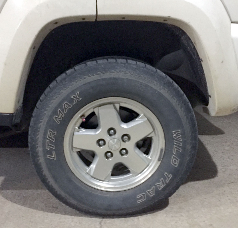

Actually I had it on a lift with the wheels off and I was only concerned with pinion angle. Rear axle was at full drop to full extension of shock travel.
I was not even thinking of axle centering which would be hard to calculate with the axle a full drop being it travels in an arc.
But I went out and took a picture and it is very very close to center, mabe 1/2 inch off. Lucked out on that one.
Tire size is 245/75/16
