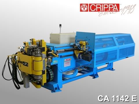

Bending aluminum is much more difficult than steel. Certain alloys bend easily, while others like 6061-T6 require much more care. I won't address sheet, plate, and flats as they all have their own issues, I'll stick to tubing. The most widely available aluminum tubing is 6061-T6. It is also one of the strongest and hardest aluminum alloys. Unfortunately, it is just about the hardest aluminum to form. To bend 6061-T6 aluminum the best thing to do is exagerrate all of the same rules that you follow in steel:
1) Support the tube with a pressure plate & die that has the radius cut into it. Have the radius cut into the bending die.
2) Use a mandrel to help with wall stretching/collapse. If you support it via #1 well enough, and have a large enough bend radius, this can be neglected.
3) The easiest tube to bend is one with a small diameter and a thick wall. Basically it behaves more like a rod, which bends very easily.
4) Use a large centerline bend radius. 3x the OD of the tube is usally pretty good if the wall thickness is at least 10% of the tube diameter. Example: 1-1/2" tube with 1/8" wall: use a 4.5" CL radius or larger. If I were using a 1/16" wall thickness instead, I'd probably bump my radius up to 6 or 8 inches. This is all trial and error, and experience. I'm sure there are some tabulated data out there with better rules, but I just know what has worked for me.
Some people cheat and heat up their tubing before bending. Basically this anneals it, removing the temper (T6) which gives the material all of its strength and hardness. Annealing to bend is not necessary. What is necessary is adequate design and access to the proper bender. I've had aluminum bend at a custom muffler shop, using their compression bender. It did not break, but it necked the tube down and looked pretty raunchy. We get the 1-1/2 x 1/8, 5" CL radius tubes for my rack bent on a CNC bender like this one
Image.
