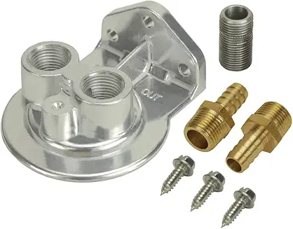

I want to pump some fresh oil through the engine & bearings before I crank it. What do I need to connect a high pressure oil pump to the oil filter threaded connection? I know it's not standard pipe thread.
Electric high pressure oil pump: Manfuacter & model suggestions... ?
Oil pump threaded connection: Maunfactuer & model number suggestions.... ?
Is there another method? Suggestions... ?

I would simply disconnect the metal oil line fitting that goes to the turbo on the side of the block. That is a direct port into the main lube oil galley in the block that feeds everything.
Adapting to this threaded port should be quite easy. Where are you going to take your suction for your external oil pump from? You could use the oil drain in the oil pan, but I would still run it through an external oil filter to catch any fine particles.
Remote oil filter adaptors are plentiful online like the Derale 15708 Remote Filter Mount.
I would NOT use a high pressure pump! You are only wanting to flush the the OIL system and low pressure would still provide the flow for this purpose and get the job done.
If you still want to use the oil filter nipple, the threaded nipple is 3/4-16 UNF threads. IT is NOT pipe threads. You will need a female 3/4-16 UNF fitting similar to the this: 1/2" ID 3/4-16 UNF Barbed Push On Female JIC 37/SAE 45 Swivel Connector
This is the flow path.

This will get me on the way. The local hydraulic shop should have an adapter (female 3/4-16 UNF to 1/2 or 3/4 NPT). So, if I don't need a high pressure, positive displacement pump, then my ordinary transfer pump should circulate oil through the lube system.
I'd like to stay with the oil filter connection because it is so accessible. I will follow your other suggestion of including a filter housing. I have some good oil that needs a good polish job, and I can use it to polish the fuel tank as well.
