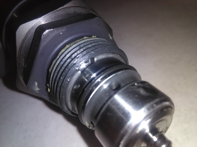

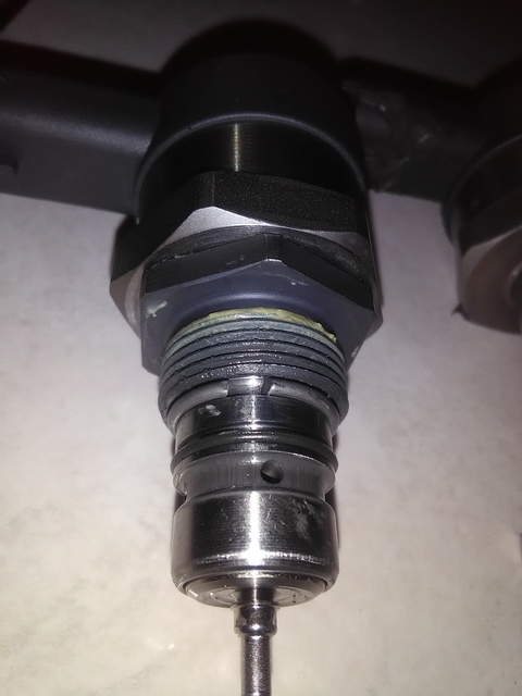

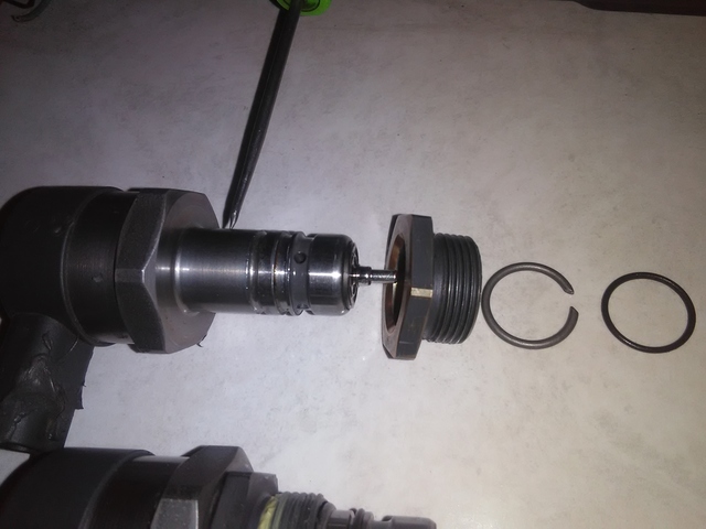

PostPosted: Mon May 02, 2022 1:08 pm
Posts: 7387
If like most other electrically controlled devices on this engine by the ECM, the power supply (5v) would be constant and the ECM would modulate the ground side of the coil in the solenoid to induce the magnetic force to open the valve. Since the solenoid is forced closed by spring pressure when at rest (engine starting), if it is leaking by and not sealing off properly, this would account for low fuel rail pressure issues during startup. You may simply have something under the seat not allowing it close fully? As you can see in the pictures below, there is a very small sealing surface for the plunger to actually seal against so any small amount of debris that were to get hung under that plunger could cause problems.
I remember one member who actually removed the solenoid, cleaned it and reinstalled it with success. I know they say in the FSM if you remove it, it must be replaced with a new unit, but might be worth a try??? See pictures below of one taken apart.
Another thought; with the solenoid unplugged, would be to ground one side of the solenoid to a good ground and then provide it with 5v supply from the BR/OR wire with a jumper on the other side of the solenoid while spinning the engine over with the starter to provide full fuel flow through the rail. This should force the solenoid 100% open electrically and maybe flush any debris out from under the seat of the plunger into the fuel return system???
--------(5v) (ground-)----------
This statement in the FSM could be the key?
The tip of the fuel pressure solenoid uses a knife edge, for metal to metal sealing. The knife edge actually deforms the metal in the fuel rail in order to seal the surfaces. The solenoid must be replaced when ever it is removed from the rail. The solenoid controls and maintains the rail pressure constant along with a control current transmitted by the engine control module (ECM)

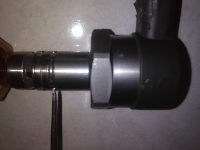

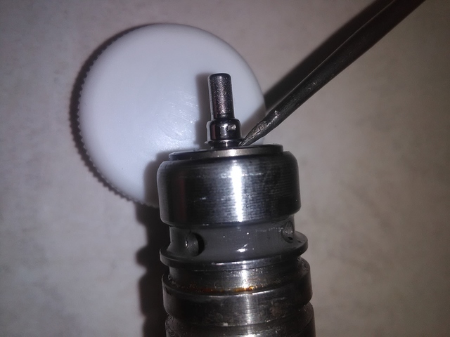

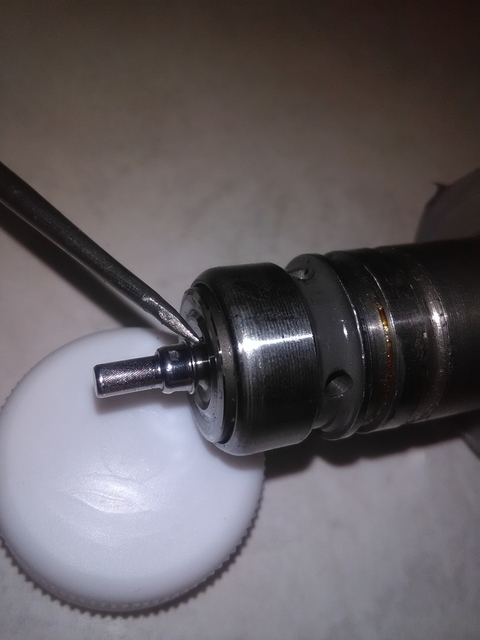

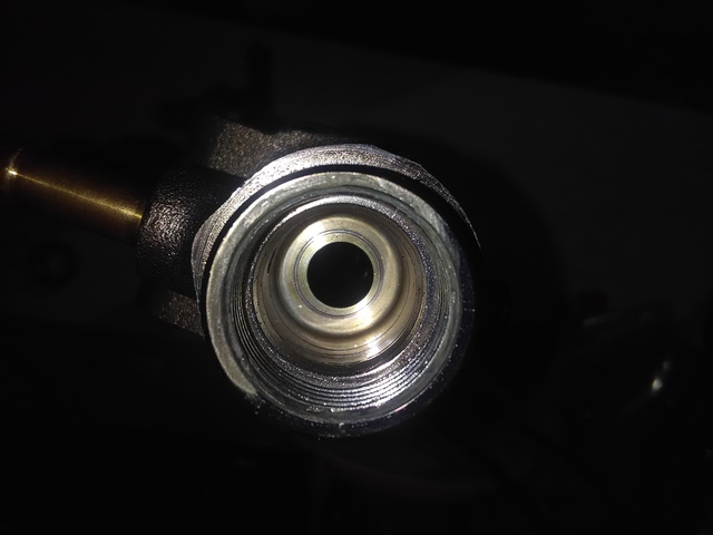

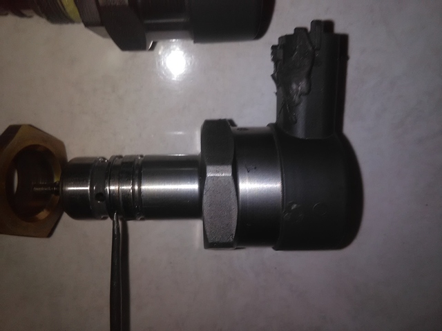

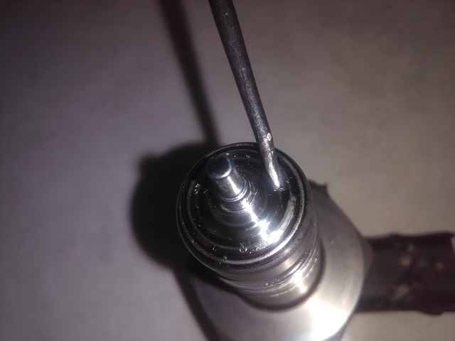

Pictures of Fuel Rail & Fuel Rail Pressure Solenoid seating surfaces with Solenoid removed & disassembled:
