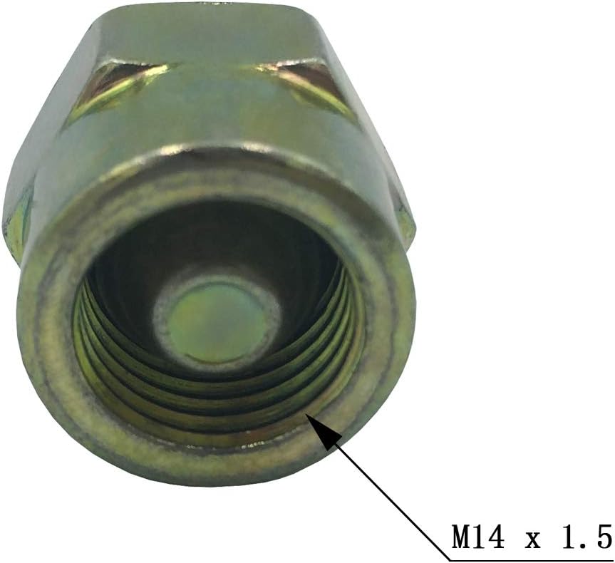

There is an INJECTOR LEAK QUANTITY test described in the 2005 FSM in section 14, page 48. > http://www.colorado4wheel.com/manuals/J ... Manual.pdf
FSM wrote:
Perform this test with the engine at operating temperature.
This test will assist in determining a defective or internally leaking injector(s) is present by measuring the amount of fuel return.
i don't think this test will determine if an injector is leaking by internally an dumping excess fuel into the cylinder.
To test for that, you would need to cap off one injector supply line at a time until you find the defective one.
The test cap could be made from any extra metal injector supply line by cutting it off and welding the cut off end shut. :D :idea:
or
order a test blockoff cap for Bosch System, several vendors including Amazon list them for sale online,
https://www.amazon.com/kweiny-Diesel-Co ... B081NGCSVW
look for:
Jeep Liberty CRD Injector Block-Off Tool / Cap :google:

Or just place a small disk of brass or similar inside the pipe fitting going to the injector.
Using a soft metal stops damage to the fittings.
