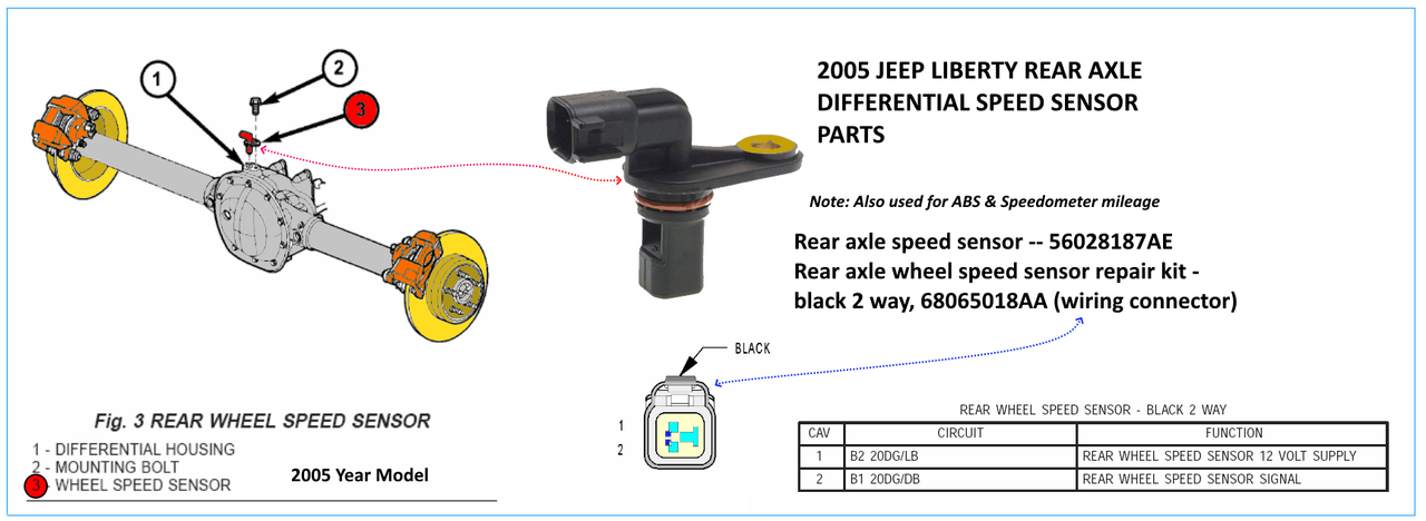

Check the wiring/connector going to the speed sensor on top of the rear axle. Some have found a broken wire where it connects to the plug.

I can check that, but I doubt the rear wheel speed sensor will be the problem. The ECM displays wacky things when some malfunctions occur. While I don't remember the details, the ECM commands the speedometer to display some absurd speed when some malfunction occurs -- I don't remember the malfunction(s) that do that but I thought it had something to do with the alternator.
Based on that, I think the AntiSkid system failure causes the odometer to stop advancing. At least that is what I am seeing; when the AntiSkid light comes on, the odometer stops advancing.

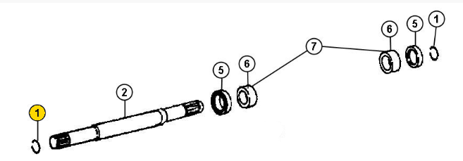

The half shaft should be held in place by a lock clip (Item #1) as pictured below.
If the lock clip is not damaged or broken, you should be able to push it back into the differential gear and it stay there.

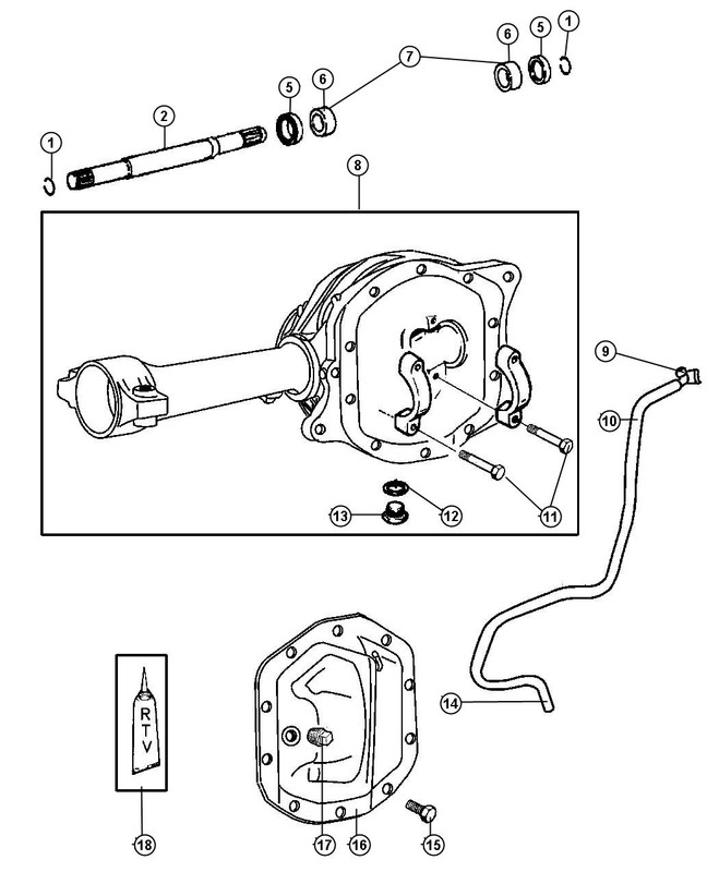

Just order a shim kit from for the 30A.
Randy's Ring & Pinion may have them, I would call. https://www.randysworldwide.com/
The 27 spline Dana 30a, also know by Chrysler as the 186FIA, has always been the only front axle available in the Jeep Liberty. It's an IFS axle with an aluminum housing as indicated by the 'FI' and 'A'/'a' respectively. Essentially, it's an aluminum version of the Dana 30 with a longer pinion shaft. Unfortunately, the light weight aluminum construction makes it weaker than the D30 and the longer pinion shaft means pinion related D30 parts won't fit the 30A. The D30a requires a 1-1/8" socket to remove and install the pinion nut.
CRD Liberty's have a different front cradle that lowers and leftward shifts the differential to provide more clearance for the diesel engine.
The lowering results in better half-shaft constant velocity joint angles but too little clearance for a differential collar. The leftward shift requires different length half-shaft axles than those used in the gas Liberty. Due to the shorter left side half shaft CRD models cannot be lifted as high before the CV joints begin to bind.

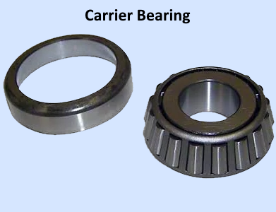

Good luck is shining on me today. The two factory spacers were 0.005" different from each other, and located favorably to allow swapping sides. Switched the spacers from one side to the other and that made a little improvement. ...but not enough. When I wiggle the pinion gear, it still makes noise against the ring gear. Added a 0.003" shim and that helped more. The preload on the bearings is still within limits.
I'm taking a break to post my progress and express my excitement. :BANANA:
The kit has 17 shims ranging from 0.012" down to 0.003" There is (1) each 0.012". 0.011" shims, (2) each 0.010" shim, then (5) 0.006", (2) each 0.005", (1) 0.004", (5) 0.003" shims. I'll continue by replacing the 0.003" shim with a 0.006" shim. and check for backlash and preload again. If I can continue adding thicker shims I will, but I realize preload on the bearings will have a limit. I suspect that adding 0.006" will be the limit.
Measured the inch-pounds torque to rotate the ring gear assembly by using an open-end wrench socket on the 1/4" drive inch-pound torque wrench: 20-25 inch-pounds to break standing hysteresis, then free-wheeling after it gets moving. I'm a little concerned about that, but it is all dry right now. After a few thousand revolutions it may free-up.
This shows a socket on a ring gear bolt, but I'm turning the 3rd member with a 1/4" drive inch-pound torque wrench.
[Edit after a break] Added another 0.003" carrier bearing preload by replacing the .003" shim with the 0.006" shim. This tightened up the backlash clearance so this is only a tiny click heard by moving the pinion gear back & forth. I'm stopping there and calling it good for now. Certainly there are other noises coming from this 4X4 machine that will make the differential noise unimportant. Measured the clearance now to 0.006" movement on a tooth of the ring gear.
The third member assembly turns rather easily by hand, and driving it with the pinion shaft is very easy. Although I could not measure the pinion shaft turning with the 1/4" drive inch-pound torque wrench, I did compare holding a 14mm socket in my hand while turning it with the wrench. By hand I could only resist ~2 inch-pounds while holding the socket. The pinion shaft turns much easier than that, probably about 0.25 inch-pounds or less.
