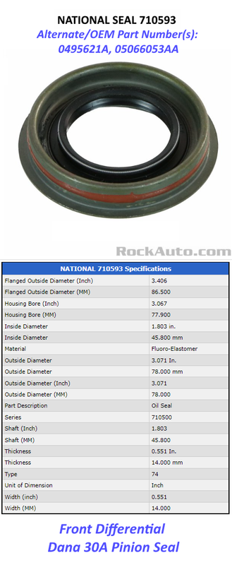

This is what I found Dean, please let me know if you see anything that is incorrect.
Front Dana 30A Pinion Seal Information
Several of the Mopar online vendors list the OEM PN 05066053AA as being available.
https://www.factorychryslerparts.com/pr ... 053AA.html
RockAuto Lists the Nat. Seal and the OEM Mopar seal. https://www.rockauto.com/en/partsearch/ ... 05066053AA
The National Seal PN is: NATIONAL 710593 :google:
Mfr ------Mfr. PN---------National
CHRYS PN: 05066053AA = NAT: 710593
DANA PN: 50619 = NAT: 710593
AutoZone lists NAT PN as being in stock: Duralast Pinion Seal 710593
Also, most of the other big box autoparts stores list the Nat. Seal PN
You can also find the Nat. Seal listed on Autozone, eBay, Summit Racing and quite a few others on line retailers.
Order or buy from whatever works the best for you. :wink:
From National Seal's Catalog:
Part No.-------Lip Mat'l --------Shaft Size -------Hsg Bore -------Seal O.D. ------Seal Width -------Type/ Illus.
710593----------V--------------1.803-------------3.067------------3.071-------------0.551-------------74

Thanks for providing this information WWDiesel,
AutoPartsPrime.com whom I had such great expectations for, just informed me my order has been cancelled. The reason is the order is voided because the seal is backordered with no ETA by the manufacturer.
I will contact RockAuto and others to see if they can provide this seal, and if they'll ship to Hawaii.

Baby steps forward. Rock Auto of Canada reports the Pinion Seal has shipped. Due in Hawaii by next Friday, Sept 16.
