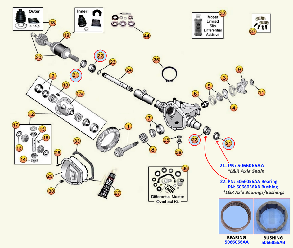

While in there, I may as well replace the bearing and seal in the end of the differential housing for the intermediate shaft. The bearing is most likely the source of the noise. It sounds like an un-regular clunking. Oy Vey.

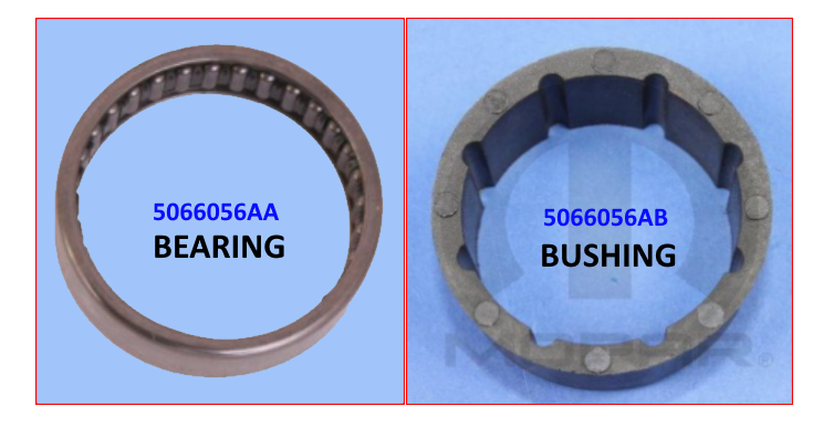

FYI:
Keep in mind, there are two different bearings, bushings with different part numbers.
I think others have reported the bearing can replace the plastic bushings.
This has been discussed on here in the past.

Thanks WWDiesel,
I didn't realize there was a bushing available. That makes sense because there is no weight load, only torque loads. The bushing seems to be an upgrade part since it has the ...AB suffix instead of the original ...AA suffix.
I already ordered from JEGS.com this morning and I'm getting the original bearing, not the bushing. I'm happy with this because it should last another 100,000 miles. By then, I'll be a hundred years old and won't remember what a vehicle is anymore.

Just an FYI, when I looked at the 05 parts fiche the bearing and bushing for the right side intermediate shaft; it is supposedly dependent on the tag number on the differential. I couldn't determine what tag number I had as I grabbed mine front diff (4:10 gears) out of the junkyard 4cyl gas Liberty. Yes, the needle bearing fit just fine and has been running good now for about 8K miles . However, I still have a slight up and down play on the intermediate shaft (without the CV axle installed) and now I'm left wondering if I should install the bushing type to eliminate some of the slope and the clunking I hear from the right side.
I have to break down the front suspension anyway since I broke a QA1 / Adjust a strut (from JBL) shock (snapped the shock rod at the threaded end) and since its torn down I may replace the needle bearing with the bushing and see what happens.
Just a thought for you,
