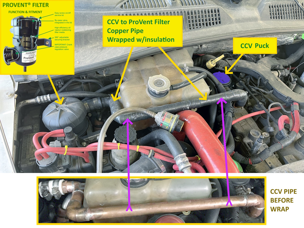

Your best solution is to add a ProVent that will remove 90% of the suspended liquids in the vapors coming out of the CCV puck.
As for piping, I fashioned a metal one out of 3/4" copper tubing and wrapping it with black insulated tape. I used silicone hose fitting to attach it at each end since silicone is impervious to heat and oil.
I like the ProVent 200 since it has a built in coalescing/centrifugal filter design along with a pressure regulator and safety valve to prevent any overpressure. :wink:

PostPosted: Tue Mar 28, 2023 12:58 pm
Posts: 7410
Yes it has two valves in the unit, one on the side regulates the crankcase pressure and the lid has a built in over pressure relief valve which would protect the crankcase from excessive pressure.
As for mine, I simply drain mine with each oil change and usually get a few ounces of liquid out of it. I also clean the filter and inside of the housing with brake cleaner.
One strange thing I noticed when I installed my ProVent 200 several years ago and I cannot explain it; at first I was getting a lot more liquid captured in it when I drained it. Now it does not seem to to be as much liquid in it as it first was, I have no idea why, but I don't worry about it as there are no engine oil leaks or other related problems.
I park my Jeep on concrete and having a 18 year old diesel powered vehicle that does not leak anything is phenomenal to me! :BANANA:
I wish I could say the same thing for my Dodge Cummins as it stays a little wet in the rear main oil seal area and it vents to atmosphere, came that way from the factory. :( I keep a thin metal pan with oil dry under it to catch any drips.

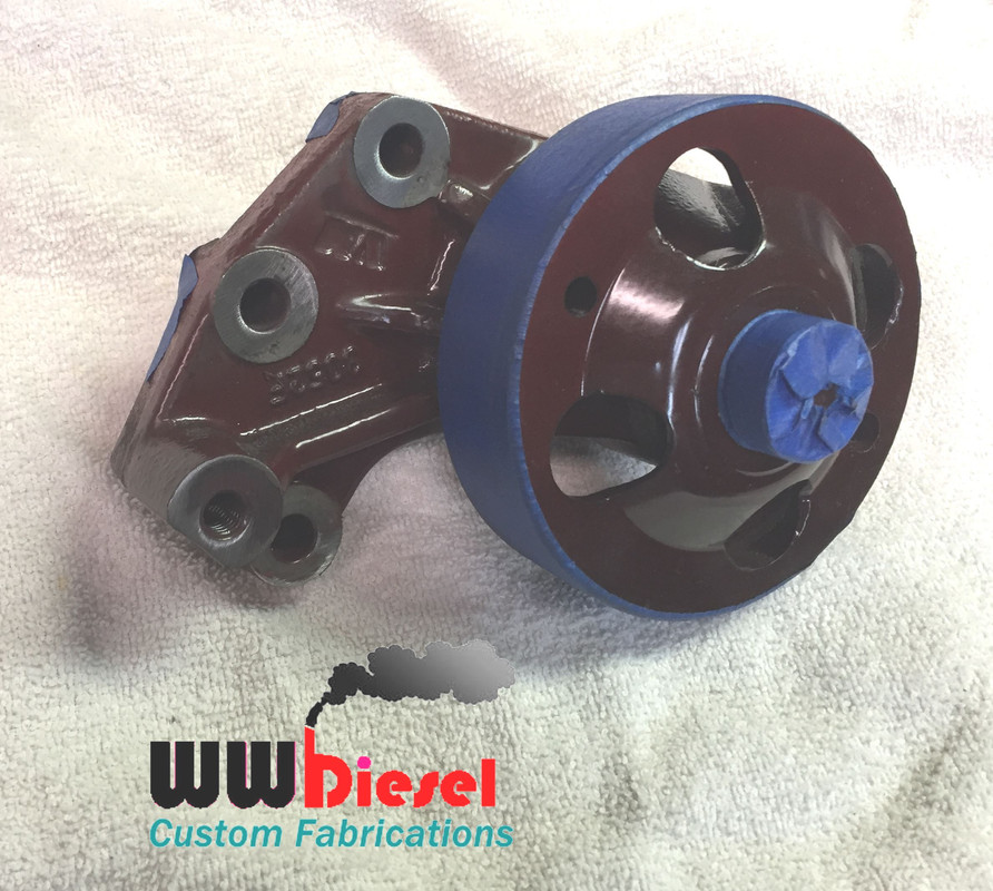

Unfortunately the OEM mechanical fan bearing is no longer available anywhere, I searched all over the world for them and there is no other exact same size or even useable size bearing that I could find available anywhere, and I contacted every major bearing distributor in the US and a few abroad.
The OEM bearing part number is a F-A-G WR01565. You can find it in the F-A-G bearing Catalog. It is a very unique bearing!
If you locate any anywhere, please let me know, I would love to order a bunch of them.
I did find one company who offered to tool up and make some of them if I placed a minimum order of 1,000 of them. $$$$
Not willing to invest that kind of money, it would be very expensive.
So I opted for rebuilding them using a slightly oversize bearing which requires boring out the housing to fit the slightly larger bearing. The housing has plenty of metal thickness to accommodate boring it out slightly. This works, have rebuilt and supplied over 60 hubs now. :D
Picture of rebuilt fan hub:

I'm planning to dig into the beast tomorrow, including installing the new ProVent 200. If you were going to do it again, would you change anything? Should I mount the ProVent a little lower than the CCV puck so no filthy oil can return to the engine? It would mean checking the oil more often and adding a quart once in a while.
Dean.
