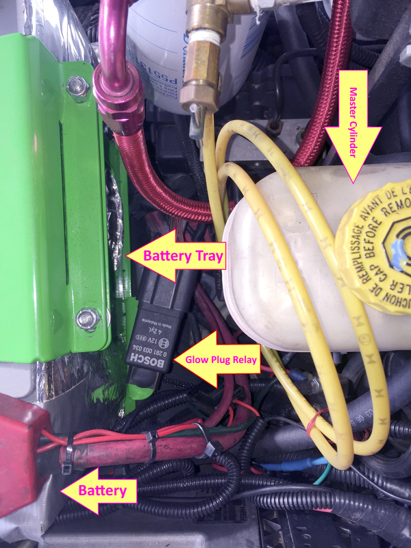

PostPosted: Sun Apr 30, 2023 12:25 pm
Posts: 7387
Hi Dean;
This is the drawing that I have on file (see below); let me know if you think it is incorrect. :?
As for the programing, I bet if you contact Yeti (Marco), he probably can rem out any GP fault codes and programing to meet your needs.
Message him on this forum, click on this image:
OR
Clink on this link to send him an email:> eMail Marco aka "Yeti"
or you can message him on facebook.
PM:> ucp.php?i=pm&mode=compose&u=42474
PostPosted: Sun Apr 30, 2023 8:00 pm
Posts: 718
WWDiesel wrote:
Hi Dean;
This drawing is backwards too. The Glow Plug Control Module is in front of the Anti-Lock Brake assembly. Move the numbers out, flip the drawing sideways, then move the numbers back in.
Dean.

PostPosted: Sun Apr 30, 2023 10:24 pm
Posts: 7387
Went out and located the GP relay on my 05; it is attached to the battery tray and is in between the Battery and in front of the ABS module as pictured below.
Pretty much like the FSM shows.

PostPosted: Sun Apr 30, 2023 11:44 pm
Posts: 718
In the interest of "I can't un-see that" I will recant my correction to the Field Service Manual picture of the Glow Plug Module location. I was thinking the FSM picture was from the vantage point of looking across the engine bay. I was wrong. The connection on the Master Cylinder reservoir should have been the true give-away.
These first pictures are taken from just over the fender. The oddly purple connector face is where the Glow Plug Module connects.
These pictures are from the opposite side of the vehicle.
