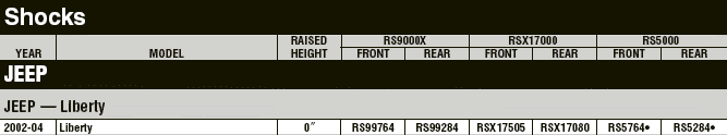

Here is the recommended shock for a stock KJ:

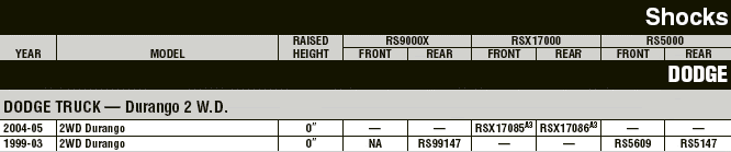

This is the 17004, which is spec'd for a 1998-2001 Dodge Durango (stock):

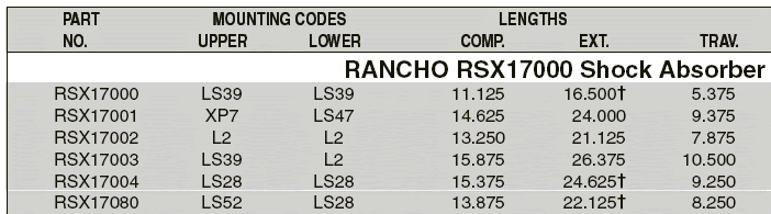

Here are the specs for the 17004 and 17080:
Notice that the range of travel is increased from 8.25" to 9.25", and the maximum extended length is increased by exactly 2.5". (Perfect!)

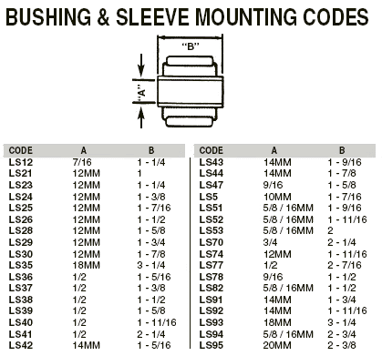

Also interesting is the upper mounting codes (LS28 vs. LS52). According to the following chart, there is a significant, but hopefully not problematic, difference between these two mounting codes:
I don't worry about the difference in sleeve mounting width (only 1/16"--negligible), and I assume that the shocks come with new bolts (12mm vs. 16mm), so there should be no problems at all.
