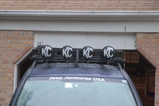

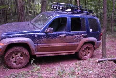

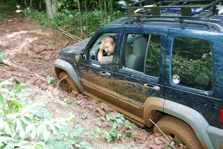

I have the 45"x60" Surco and love it. This is the second one I have had. The first being on my Cherokee. Its aluminum so it will not rust and is lighter weight. It lends it self easily to modification. I have custom made mounts for my Hi-lift, front off road lights and rear backup lights as well. To mount I used U-bolts and attached to the OEM rails. See the last photo.
This link will show you close ups of the U-bolt mounts, lights and wiring.
http://s39.photobucket.com/albums/e176/W3CSX/KCs/

Does the 45" Surco hang over the side of your OE rails?
Are those custom u-bolts or did they come with the basket?

Jason, can you individually control each lamp from those switches to the left of your steering wheel?

The switches are L-R. Back-up lights manual on / off / auto on when in reverse; driving lights on the bumper on with high beams / off; spot and flood lights(the four on the front of the basket) on / off; and on-board air compressor on /off.
Thanks,

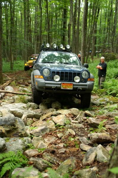

The 45" rack hangs over just about 2 to 3" on each side. Surco’s web site recommends the 40". I tried it first but the cross rails on it will not cover the OEM bars. One the front they miss by 1/2". The basket it self is narrower than the factory rails and I thought it looked goofy. This rack is no wider than the jeep and looks more robust. The U-bolts I made. Have to admit I stole the idea from JeepinAl.

LostRenegade,
This is about the best head on shot I have. You can somewhat see the overhang from this pic.
If you want I can get a direct square shot tomorrow. It’s already too dark here on the right coast.

I think you have a 45X50 not 45 X60.

Oh I stand corrected it is a 45" x 50". The longer one will work too. But, will stick almost out to the windshield.
