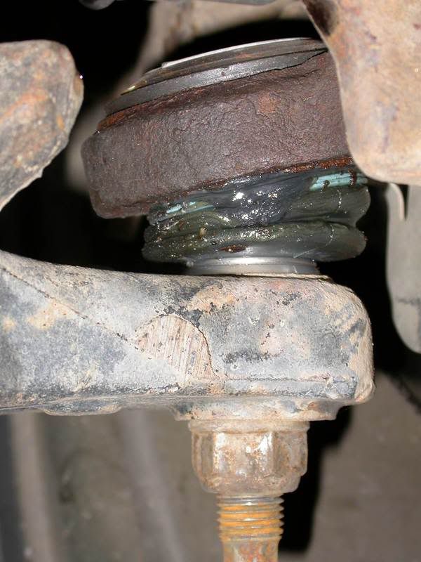

I had my lower ball joints replaced two weeks ago.
I just noticed they are leaking grease. Sealed balljoints shouldn't leak right?

I wonder if it has something to do with how rough the casting is on the lower arms. It doesn't look like a tear or anything - it looks to be oozing where the boot meets the arm. maybe you can clean up the area and try to tighten down the joint a little more?
interesting, yeah i think that may be a good start. You would think that the tech would clean that up w/ a wire brush or somthing? Thats quite a bit of rust on there.

I would take it back,I agree it looks like a poor prep job and another quick failure.

The joint may of just had to much grease in it? The surface it touches wont cause it to leak. It has a clamp around it to seal in the grease. I would give them a call and see what they say. It doesnt really matter anyway, after a recall like this they must replace them for life.
Ohh, and pixs, if you look at the joint, tighting it more wont put more pressure where its leaking.
I have a question, i had mine done under the original 02 recall earlier this summer and they are slightly loose again. Is it something that i could just "tighten" the bottom nut on there and it tighten back up? or does the thread stop?

SD-KJ wrote:
-Nick
Nope, if it has play in it then you need new ones... Again.. As you said, the threads stop. :wink:

Maximum Carnage wrote:
Dumb questions but what is a MOOG. Never heard of it.
Also are their any LBJ or UBJ with zerks installed? Greasing them once in a while the easy way would help.
Moog is the manufacturer of serviceable ball joints (with zerks installed)...so you can grease them once in a while. :D Keep in mind that you have to replace the entire upper arm as the stock UBJ is permanently attached.
Info on the lower... http://www.moogproblemsolver.com/downloads/PSL200527010PrematureBallJointFailureOnJeepLiberty.pdf
and the uppers...http://www.jeepinbyal.com/files/index.php
