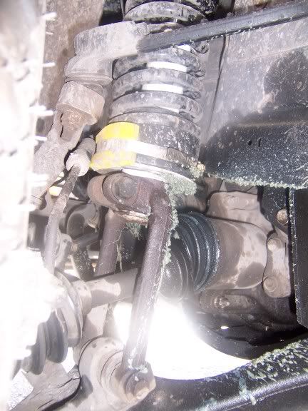

After getting the Frankenlift installed last weekend (lots of help from LostRenegade) and driving it for a week the front end has not settled at all. Naturally I looked under the KJ to check the CV angle and to my suprise there is greenish-white gobs of something (gotta be grease) ALL OVER the place. Both arms, steering knuckle, wheel well liner - EVERYTHING!
WTF, over? Question #1: Can I still drive my Jeep if I don't use the 4WD?
Question #2: I obiously need to replace the drive shaft. How much is an OE shaft?
Question #3: Besides OEM, is there another (stronger) alternative?
I'll get some pics up later today of what I am talking about...

While my KJ hasn't blown a CV boot open, I can tell you what it is like for a normal FWD car.
Sounds like the boot may have split open. As a rule, CV boots are like belts in the fact that they need to be inspected and replaced when they start cracking. The function of the CV boot is to keep the grease in to lube the CV joint. With Honda (I was a Honda car mech for about 17 years), once the boot torn I would recommend outer CV joint replacement because of crap from the road contaminating the joint.
As far as driving it is concerned, as long as the joint hasn't come apart (takes awhile to occur but I have seen it) you can still drive it.
When the joint gets completely dry, it will wear much faster and start making noise when you turn. It will make a rapid knocking noise.
You may get away with just CV boots. If the offending axle is quiet, it may be OK. If it's noisy, you will need an outer CV joint or half shaft (depends on how good of a deal you can get)
As far as a stronger axle, I don't know of another alternative.
On a side note, I am curious to see how much of an angle the Frankenlift puts on the front axles. Anxiously waiting to see pics.
Hope this helps.

Torn CV Boots can originate from different things, but having both boots torn is definetly because of the lift - taking a good pick of the angles of the cv joints will help some of us that have the same lift figure out how much more angled they are compared to ours.
I've had my franken for almost 9 months I think and have not had any issues with the boots at all - I wheel pretty hard and very often and fortunately do not have that problem. seeing some pics will help - I'll take some of mine today and post later.

Here's a shot of mine. It tore not too long after I installed my lift and went wheeling for the first time. However, I only tore a boot, the CV was not damaged. And it was only on one side (driver's side). Since I replaced it I have had no other CV trouble.

Is it truly "blown" or is the boot ripped but repairable? I know that I'd have to actually look at it for a tear but with the amount of grease thats come out I am not sure if its salvageable...
To me it looks like the inner CV boot is torn. I would try the re-boot option first. It should be cheaper than another driveshaft.
That driveshaft angle also looks pretty extreme to me.

A couple of things,
The bump stop is on the top, to put pressure on the entire structure. If the bump stop is on the bottom it it would rip out the lower ball joint right out of the spindle.
And yes the boot is ripped. If you can find the hole and its not tear you can fix it. I used brake cleaner to clean the boot, an file to rough up the area and silcon sealant. inject a little sealant in the hole to make a plug, put some on the outside smooth it over the hole with minimal pressure. Let the KJ sit for an entire 24 hours. Pop the lower band off the boot, slip a needle grease fitting between the axle and boot (make sure you don't put another hole in it and fill that bad boy fill of grease. If there is a tear, you are SOL, time to change the boot.
Next question, is did you forge any rivers or puddles, mud bog or anything else like that before you discovered the hole. If you did you will need to clean the CV joint out. So replace the boot at that time. Most likely the CV is not toast. Keep driving it and it will be.
As for the poor angles, it appears that the ball slots in the housing catch the axle shafts causing the binding. Jeff Daniels Jeep has cut the housing down or back and regrooved the retaining ring, eliminated the bind. Neat trick.
The JE Reel shafts are really HD, I have beat mine to death and they are still going strong with minimal snap crackle pop! In fact if you grease all your CV's the binding noise will all but be eliminated.
Hope this helps a little
Al

I have yet to have CV boot problems, but when I took the Jeep into a dealer to look at my transfer case, he told me that the front suspension, when fully drooped, put the bottom of the strut (where it fits into the clevis) right on top of the CV boot. I checked this when offroad and flexed, and he was right, even with my front swaybar on! I was amazed that I never tore it, but now I have Al's Arms and when my suspension is fully drooped the bottom of the strut is moved further out and not close at all to the CV boot. I have an older Frankenlift, with different front springs than the newer ones. It may just be a Frankenlift thing. I'm so glad I replaced my upper a-arms because now I don't to worry about this problem or any upper ball-joint issues.
All you guys should check on this if you have a lift and stock upper a-arms. It could very well be a problem if the bottom of the strut is rubbing the boot while it is rotating. I'm sure it varies with what lift you have on your rig.
