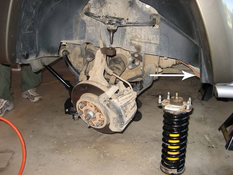

Arrow marks the spot :)

look in the front wheel well,now closest to the doors ( backside) there should be a piece of plastic sticking out behind that is the pinch weld,or if you still are confused turn your steering wheel to the left 1/2 way & the backside of the tire will come close to hitting it,that is the pinch weld
I don't have pic's but I'm sure someone will post for you,just trying to explaine it clearly for you :D
